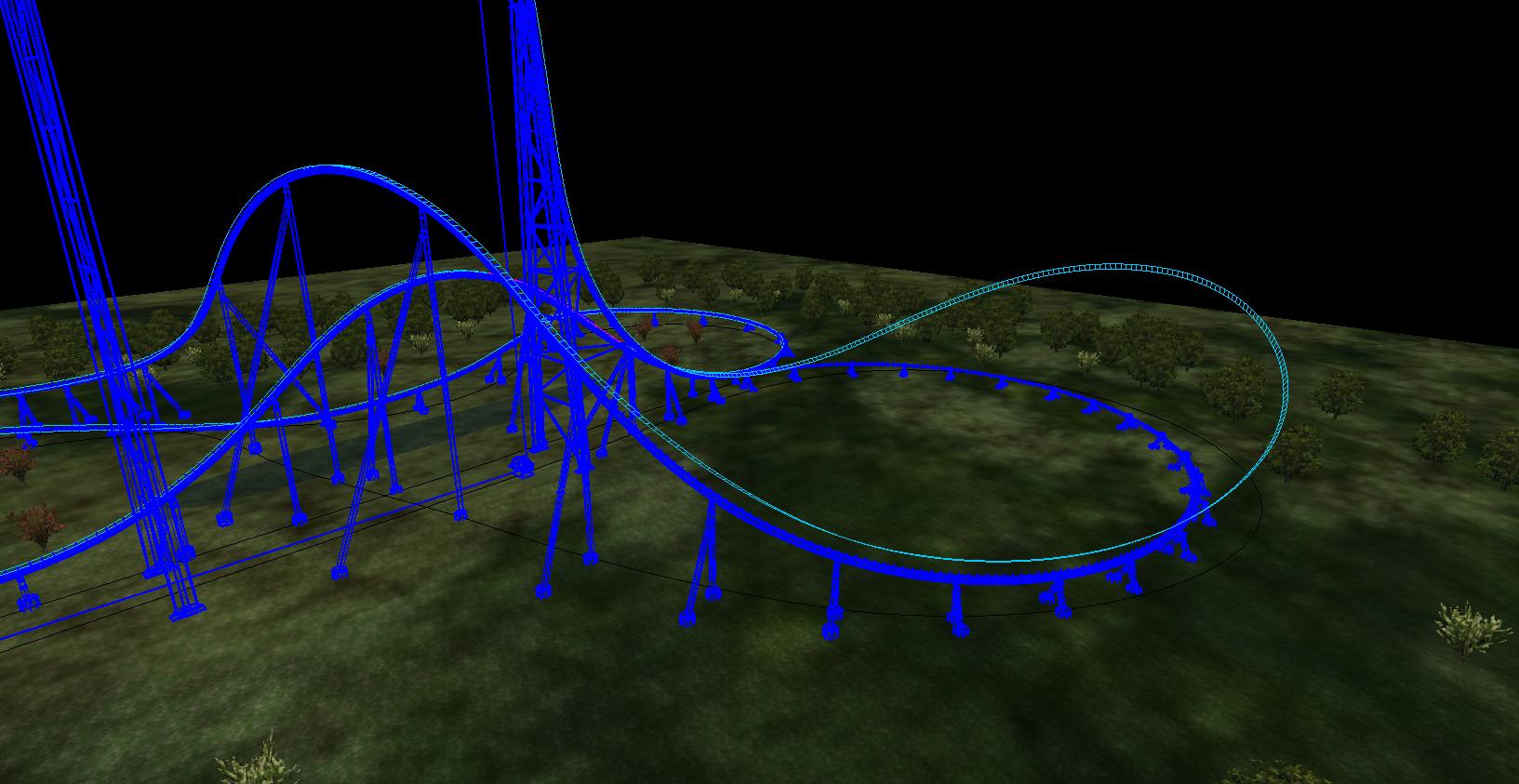

They can raise the majority of the turn without significantly reducing the top speed by either doing something like the NL picture earlier in this thread, or inserting an overbanked turn. I'm thinking medium height overbank (maybe 80-100' tall), but without tightening at the top as Intamin does on most/all of their overbanks. I tested and got around 2.9G at the top of a turn like that. The top speed would be restored, the duration of extremely high speed would be reduced (to help with the mechanical issues), and the forces would be significantly lower over a good section of the turnaround, which would provide some respite for riders.
Here's my sketch. Thanks A113.

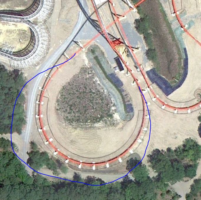

You've got to take into consideration that Rebel Yell is right next to that turn, and there may not be much, if any, room for supports on an overbank as you have, dcs, and especially if the radius is widened as well. Though I can't come up with a better solution, so I guess we'll just have to wait and see.
EDIT: On Google Earth, you can see that there's actually a service road between I305 and Rebel Yell. So, who knows, it may be feasible.

Still plenty of room to extend the turn.

The turn radius in my design is only slightly larger than the first version of the turn. Also, even if Rebel Yell was in the way, they could have the supports facing inwards like Bizarro SFNE's overbank, which means they wouldn't take up all that much more space.
