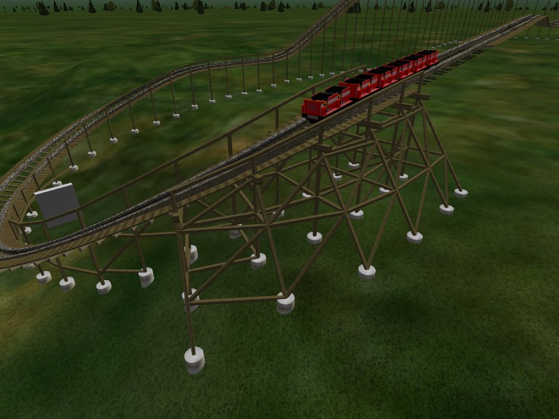

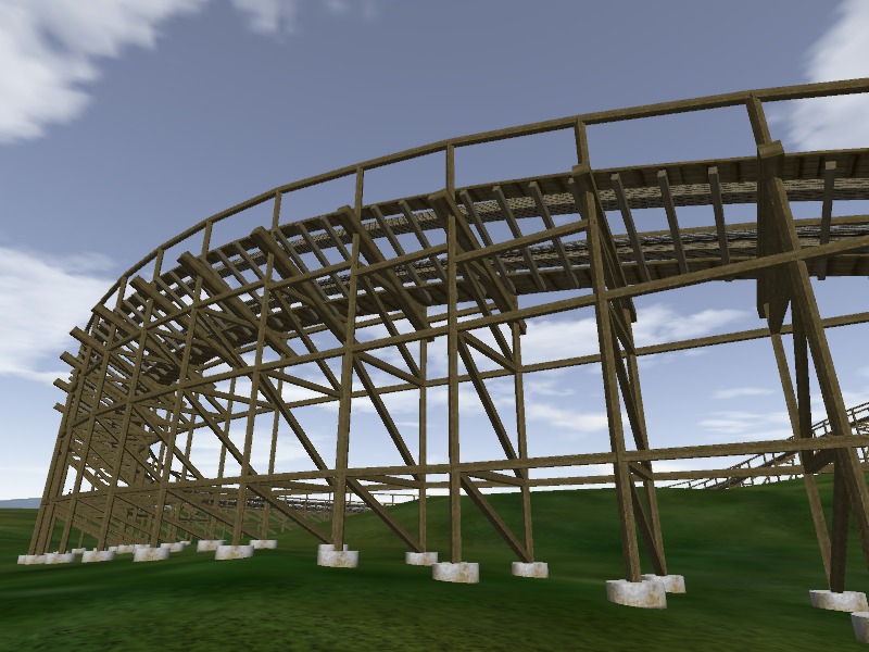

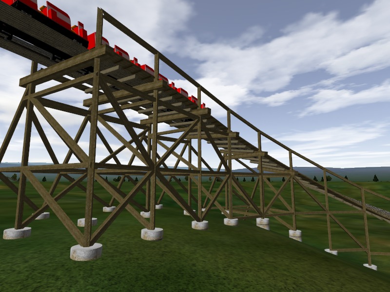

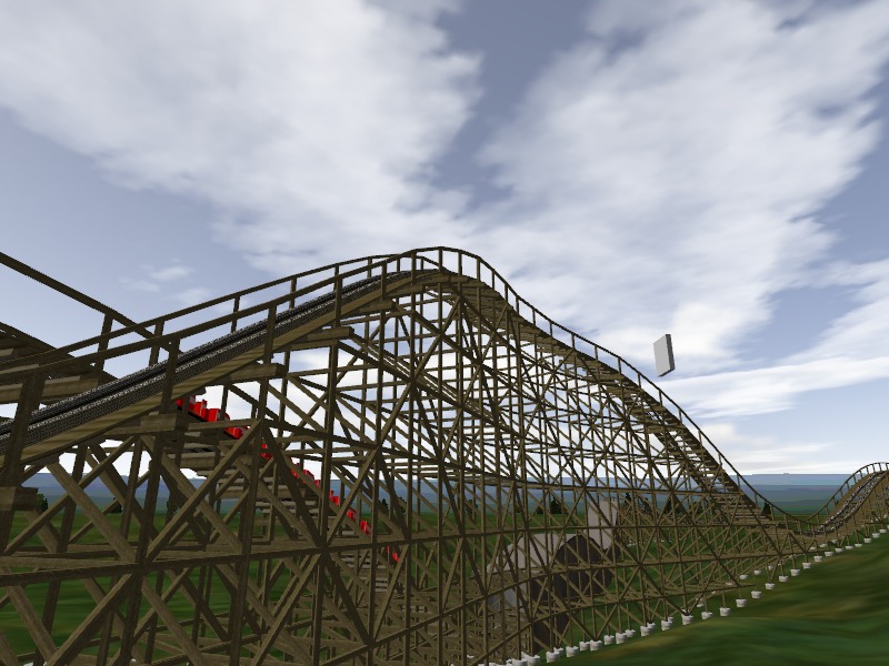

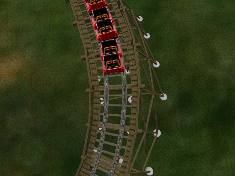

Lately my ability to finish and upload my rides has been very weak. I started up but was still unsatisfied. But I am starting to experiment with my woodies and I'm trying something new and gernerally a bit more advanced then what I have done in the past.
I've noticed that the box in the supports programed in NL are a little taller and wider than realistic CCI, or the general wooden coaster. Im 100% custome supporting this baby (except catwalks of course). Its generally a simple design but I need to start simple then build up as I get more experienced.
Here's a taste of what it will look like.

Nice...turn.

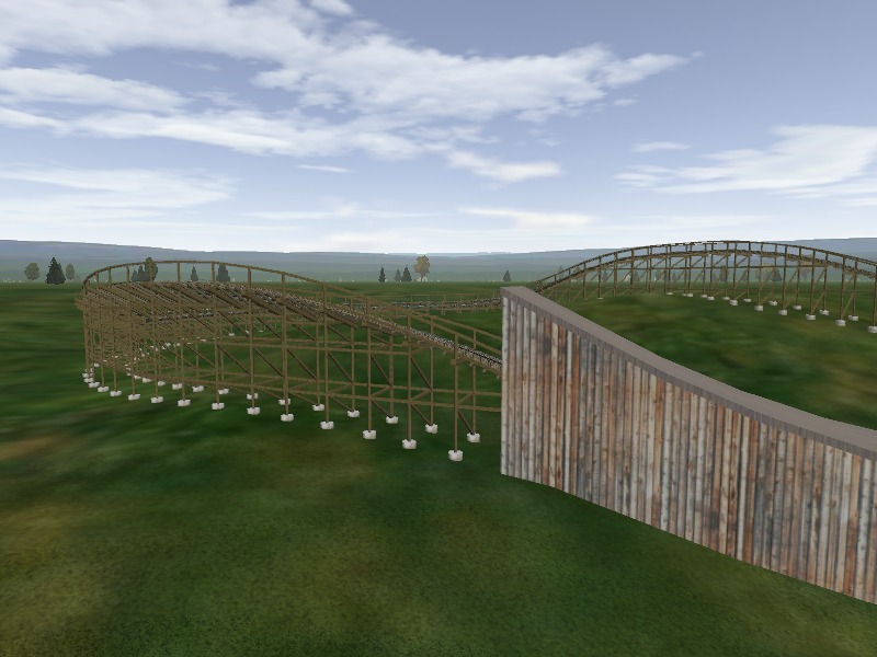

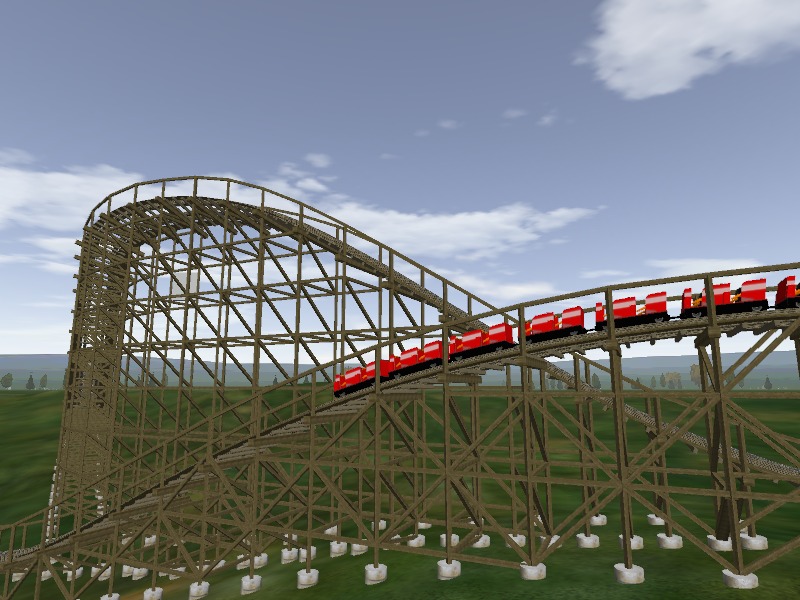

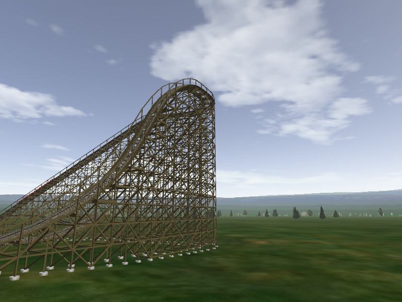

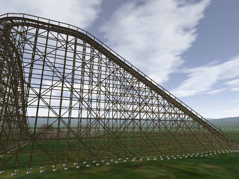

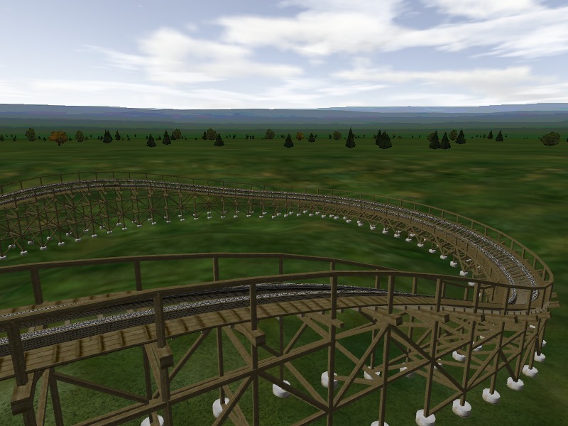

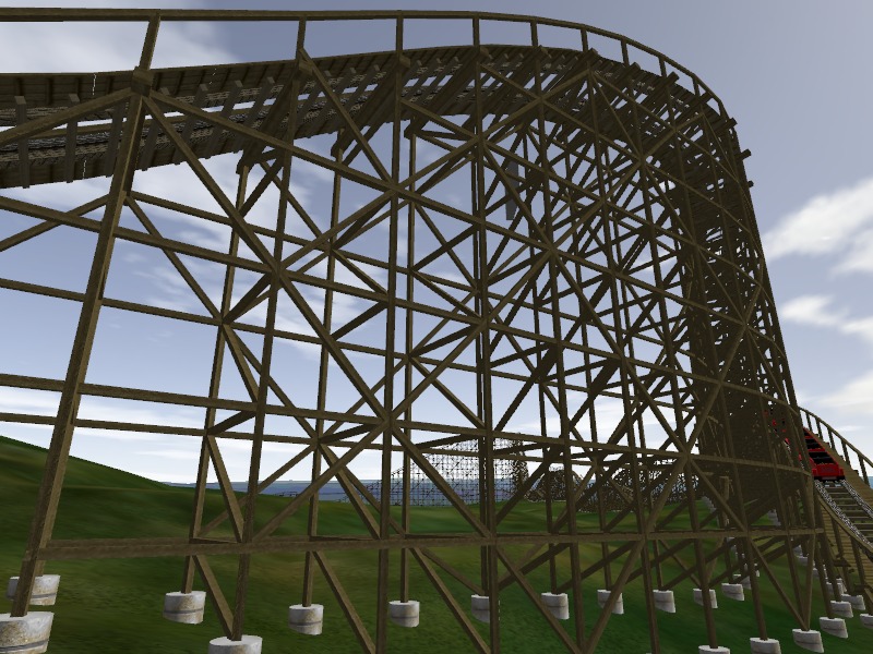

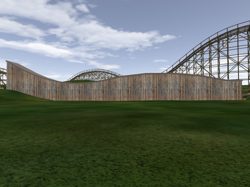

Progress has been made, slowly, but surely.
Progress
Trackwork: Complete
Supporting: 50%
Terrain: 90%
Others: 0%
Pics
182.14 KB
106.67 KB
141.89 KB
140.01 KB
103.05 KB
Please note I haven't even started on lateral bracing. The supporting under the track gives you a whole new view on how easy lateral bracing is [lol].

Those are some of the best custom supports I have ever seen!
Post February 15th, 2010, 10:10 pm
Posts: 2077
Tunnel looks great and very nice supports. Looking forward to this.

Alright I'm keep this topic updated as much as possible.
200ft+ long tunnel.

Yeah, the supporting is some of the best I've seen. What is the floating thing for?
Post February 17th, 2010, 5:40 pm
Posts: 655
^That's what I use to measure the support boxes. I'll have a 7 by 7 ft 3D box to make sure the supports are generally even.

Posts: 2077
Don't want to ruin it for you or anything, but the correct spacing on CCIs is 9x9 or 4.5x9...Sorry lol.
Post February 17th, 2010, 5:47 pm
Posts: 655
^Meh, thanks. I'll just keep that in mind for my next coaster. ;)
I've never been on a CCI coaster or near one so I was sorta just guessing. I guess it's too late now :P
Edit @ Freddie: Are you sure there's a "proper spacing" for the supports? In this picture,
http://www.rcdb.com/526.htm?p=459
If you count how many support boxes are stacked up on the life hill, you will get a count of around 17, and the lift hill is 118ft tall.
I'm not sure if I'm thinking this through right but the height spacing cant be 4.5 or 9 ft because 4.5*17 = 76.5 and 9*17 = 153. Tell me the hole in my logic becuase I'm not saying your wrong, I am just curious.

What's the proper spacing on an Intamin Woodie, and a GCI Freddie?
Post February 18th, 2010, 1:13 am
Posts: 2077
Vertical spacing is 6' or so (it varied based on how close to the ground they were and whatnot). Horizontal spacing is 9', and each square step of the structure (lateral bracing) is 9' wide. The lean-to batters varied based on where on the ride they were. The horizontal spacing over bridges was a bit different. They basically took the span of the bridge and divided it, so you'd end up with spacings of like 9.810 and such.
I have no idea for Intamin, and GCI would probably be around the same although I think they use 3 horizontal spacings instead of two (though I'm not sure what they are exactly). I have never seen blueprints/foundation plans of either type though, whereas I have with CCI.
