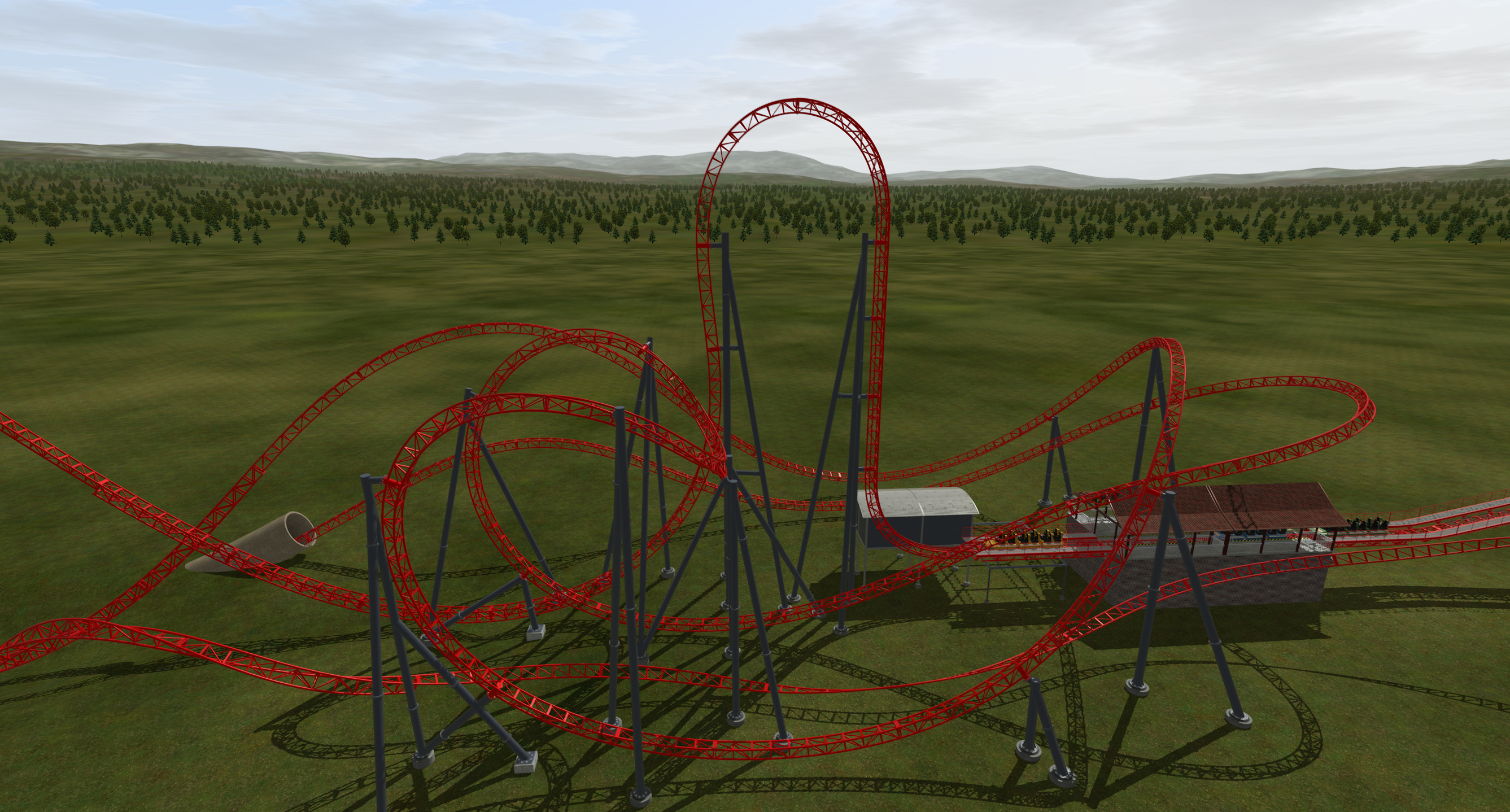

Lift supports and transfer track/storage shed are up. Turns out the track actually runs OK with 4 trains.
One side of the lift supports are kind of a mess/nightmare because there's track in the way of where a major support should go. I don't know if my current solution is reasonable. SOS.
Make the main shape of the supports into a triangle shape instead of a square (like TTD) so that you can avoid that issue. The random floating pole propped up by the two others just looks odd.

Hmmm that triangle idea isn't a bad one Coasterkidd; the problem is I still don't know if there's room on that side of the lift. I'm on my Mac side so I can't open NL2 right this second to check. That would definitely be more elegant than Ckidd's arch suggestion, but do you think the arch would work if there's simply no room for the triangle?

Also the triangle supports would work best, but if you went with the arch, a literal arch since a square arch leaves all the stress from the vertical column on the center of the horizontal beam.

Okay, that's what I thought to all of that. The arch doesn't seem very intamin-y, makes me think more of Zierer and Wicked. I better figure out how to do the triangle somehow.
Just to be clear, did everyone mean for me to basically do the same style supports as TTD on the lift here, or to stick to the Int. vertical lift style supports found on Fahrenheit and like I have now but with a triangular shape versus rectangular? Sorry I have so many questions, most of the time my rides don't even end up supported...

Triangle lift supports still weren't doing it so I actually went for a more pentagonal thing. It's definitely not perfect (and still needs a bunch of detail-related things around) but does this work well enough to keep? Just the basic shape, that is. Yes I see that one square footer lol.
I can only worry so much of some of the specifics being discussed here. While I want this ride to be relatively realistic and relatively Intamin-y, the big goal is to have a solid track that's 100% custom supported for the first time. If the shaping isn't perfect everywhere (or anywhere) so be it, although I think it actually turned out quite well in some spots. Still wish that first air hill was bigger... But by all means, carry on the conversation!
edit: I actually have one more version of the lift supports if the above if no good. I'm not really sure the alternate is better so no sense in posting it yet.

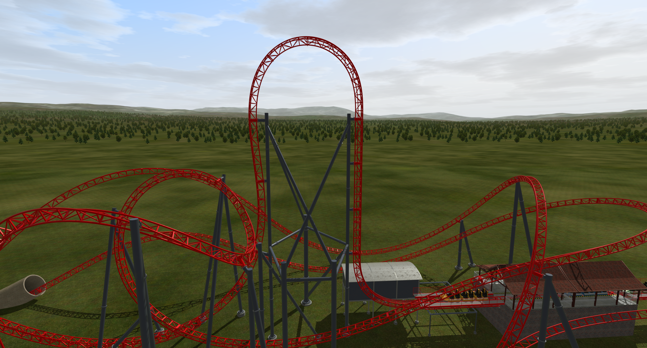

Have you attempted to use inspiration from the the other intamins at Hershey? I looking at Inamin top hats should help give you some more ideas on how to solve your problem. Most relevant to the style you're going for seems to be Storm Runner and ispeed

Yeah I have considered that, I honestly just hadn't gotten to that point yet. I don't think I have a choice now. I had really, really wanted to do the vertical lift supports as they are on Fahrenheit-- not for any particular reason, I just think they look cool-- but clearly there just isn't room on the one side and top-hat-like supports will indeed probably look better here.
I think you're right that the iSpeed/SR style or something close to it will be my best bet. From what I can see it appears that most of the supports on those top hats fall under the track, versus spreading out much to the sides? I think that's exactly what I need here. Obviously I have some room, just not a lot.
I guess the biggest difference is that I'll have to bring those SR/iSpeed supports up higher than they are on the real-life examples because the actual self-supporting arch is much narrower in this case yes?

Ride looks good though only just noticed it! You'll definitely need the supports up higher for the exact reason you stated - keep up the good work!

I will return with pictures ASAP. I'm hesitant to move forward with the rest of the supports until I feel like I've settled on a lift support shape. I think the iSpeed/SR top hat supports will work fine but I can't quite visualize how they'll work as they come closer to the ground. I'm sure I'll figure out something.
Post February 24th, 2015, 7:30 pm
Posts: 274
Kind of a cross between the iSpeed/SR top hat and vertical lift supports. In a rush but can provide other angles upon request.
Also there's one misplaced support but it's not super noticeable in the picture. Already taken care of.

At the moment, it feels a bit under supported, maybe add a bit more support onto the side without the track underneath/in the way.
edit: nevermind, I just opened up the image full size and saw that there was already a support there.

Sorry I should have been more clear that not all the lift supports have been placed anyway so you are right it's a little undersupported. I still have to do some stuff around the bottoms of the supports but since I've now done four or five different versions I just wanted to post with the basic shape/major supports to make sure I finally have the basis of something that should work.
