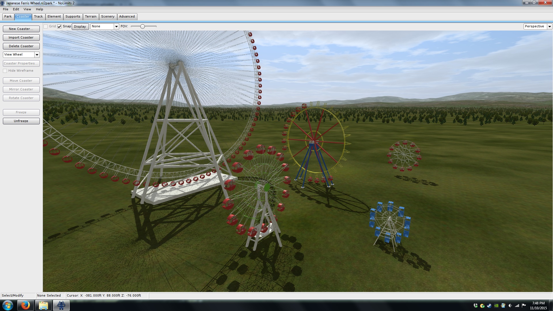

Speaking of scripting,
NL2 really needs more than 2 scripted Ferris wheels and about a dozen very high detail scripted flat rides that are available for anyone to use. I have made far more support made ferris wheels than people have scripted or animated since NL2 released.
I think Themepark Studio has way way more fan made flat rides so far. That game is suppose to have a very easy to use system for making animated rides. Not scripting. I believe the need for scripting to animate objects is SEVERELY limiting the amount of people who can make animated flat rides. I know that the keyframe animation thing is new but has anyone even used it yet and released a object or a flat ride that they have animated? If you could only convert a support and free node made object into a file that blender could use, or that could be scripted to animate, than people might could make more flat rides easier. There has really got to be a easier and more user friendly way to make flat rides.
