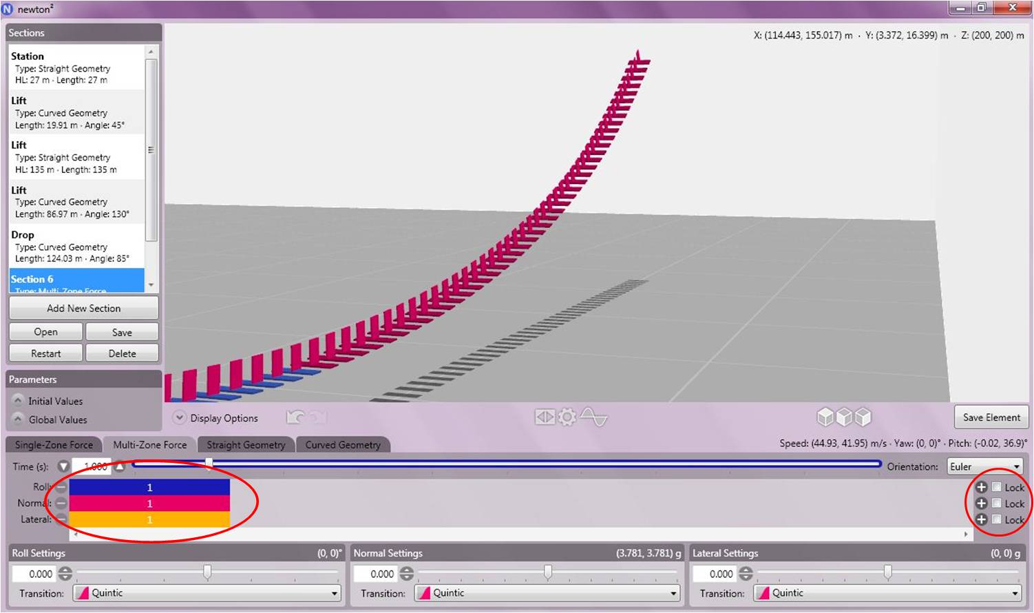

I have fiddled with Newton 2 for awhile now and I am having trouble with only one aspect of it - the Multi-Zone Force. In this picture below, I need to know what the circled functions do (the ones with the red outline). If I can master this, then I would be able to make decent tracks instead of bumpy ones. Help is greatly appreciated!

They are time zones. The red represents vertical force, the yellow represents lateral force and the blue is the roll. On the right, you can add a section or lock one. When you lock one it goes with the shortest time-line and has the same time. You can change the section length only based off of one force. So, you can have a whole section of vertical force while the roll and lateral force are split up into two. That way you have more of a likeliness to get what you want.
Check out the tutorials to understand the concept better.
