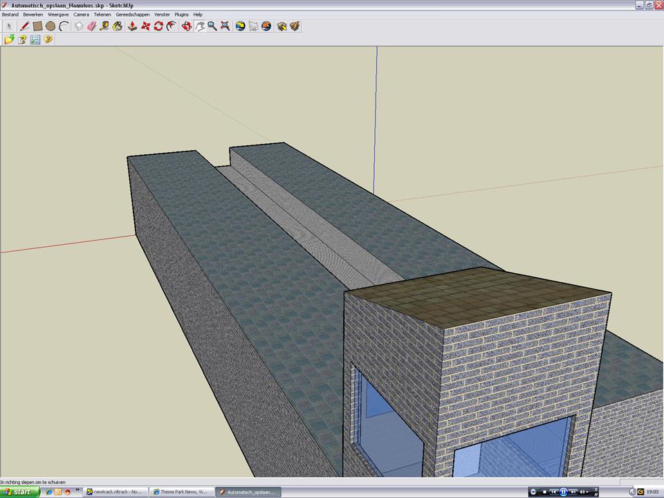

i am making a coaster and a want to make a custom station with sketchup (i have a 3Ds exporter).
when i import the 3Ds file into my coaster is everything normal

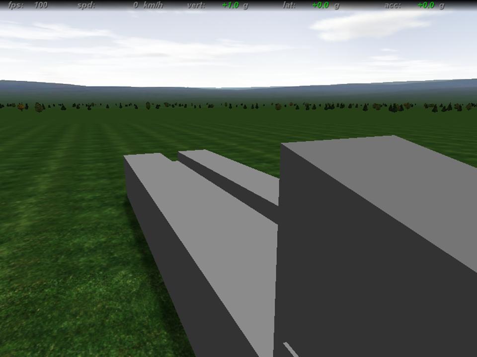

but when i start the simulator the custom station has a grey color.
94.24 KB
sketchup
44.88 KB
simulator
did anybody now how to fix this
Post April 7th, 2009, 1:24 pm
Posts: 409
You need to place the sketchup textures into the NoLimits Coasters Objects folder. Then you can view your textures :)

http://www.nolimitsdevcenter.net/p4748
This may be of some help to you...

thanks,it helps my alot.[:D]
