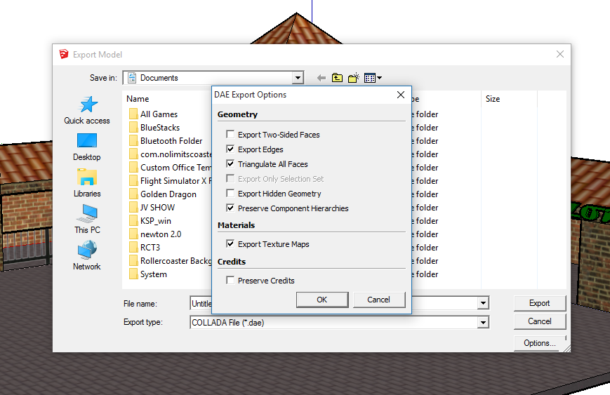

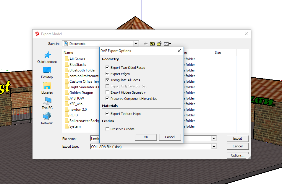

I had the same problem, here's two things to fix. First make sure the name of your file dosen't have any spaces. For some reason if there is a space its looking for "my%20example.dae" instead of just "my example.dae". Also to fix the issue with sides facing out/in, etc. do this:

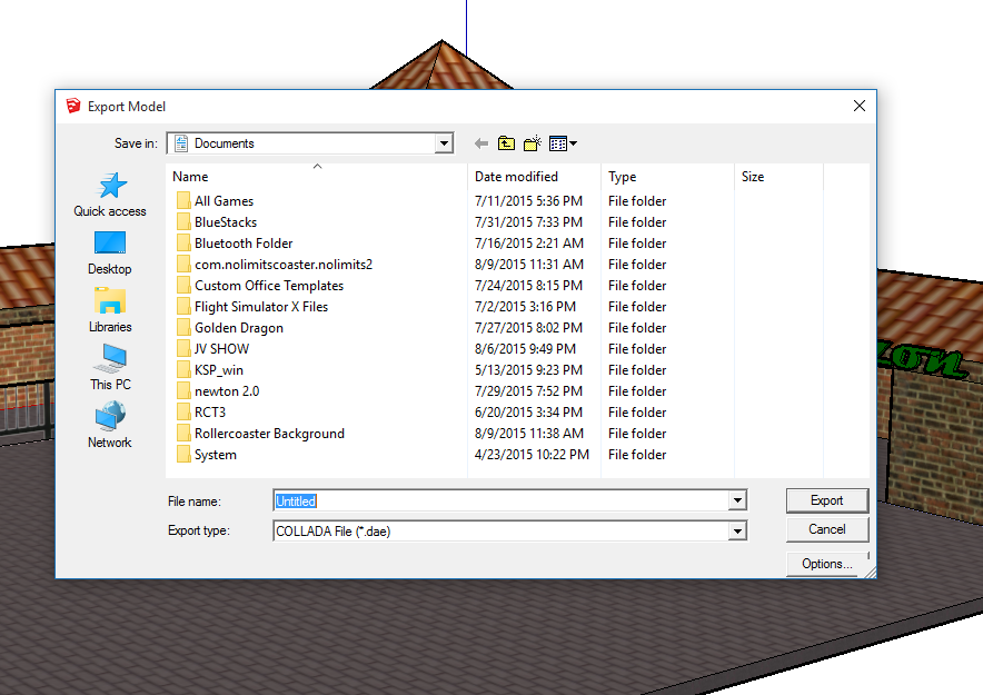

Click the options button when exporting
Then find the check box that says "Export two-sided faces"
Then check that box to export models as they appear!

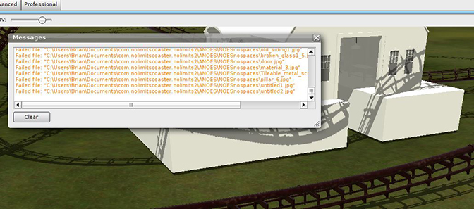

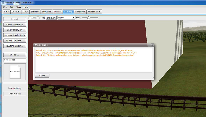

The only selection I didn't have checked was the "Export Edges." So after giving it another try I still get the same errors messages. Do I need to direct it to the texture files somehow? I feel like I'm still missing a step. You can see in my screen capture that my model loads, but with no textures. If I paint a surface in sketchup, that surface will load in NL2 with said solid color...but no bitmaps.
I did use some underscores in the texture names. Would that be a problem? I feel like I have the right "white sides" facing out in sketchup. Does NL2 somehow invert the faces? Should I face all blue sides out?
Here is my screen capture:
the warnings after I place the newly created NL2SCO file

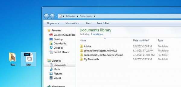

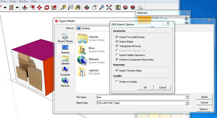

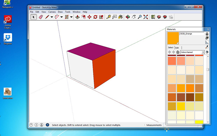

Thanks everyone for your patience. I'm sure it's just something obvious I'm not doing. Sorry for the long post. Here are my steps:

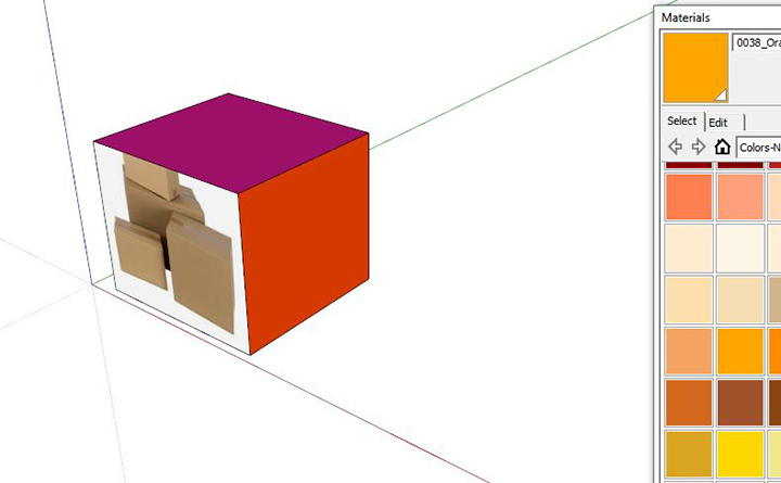

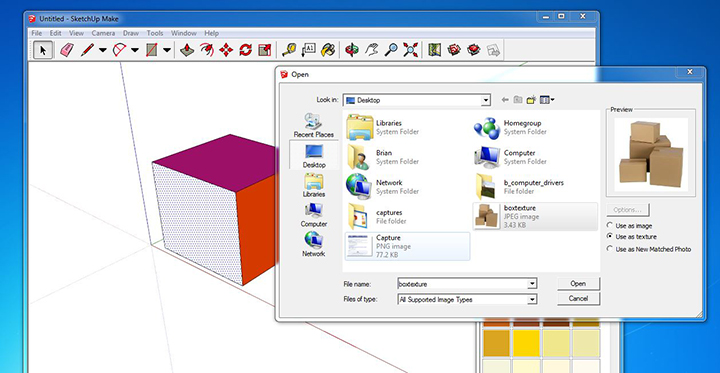

built simple cube and painted 5 sides with Sketchup palette. Leaving one side for texture jpg
imported file called "boxtexture.jpg" on 6th side
texture appears in sketchup
check each box except "export hidden geometry" and "preserve credits"

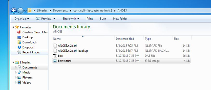

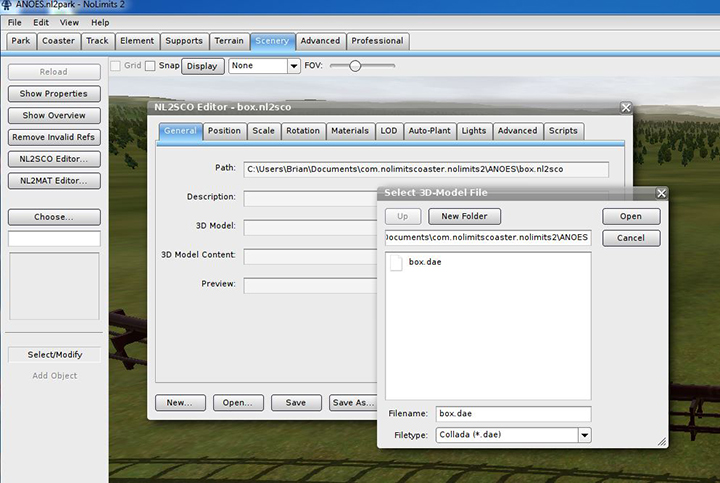

I pull "boxtexture.jpg" and "box.dae" into my no limits 2 park root folder

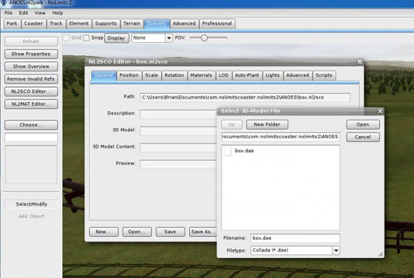

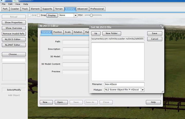

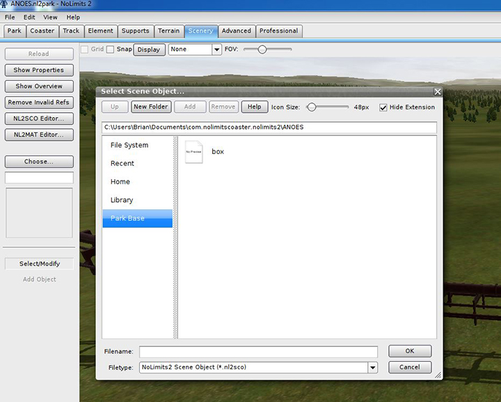

I select "NL2SCO editor" and name my object file "box.nl2sco"
I select "3D Model:" path and direct to "box.dae" save and close
I select "choose" tab then select box file I just created
the box is imported with the 5 colors with these warnings and no textures

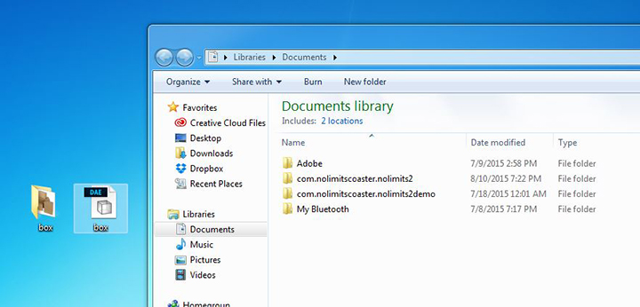

"export to desktop a box.dae file, and folder containing boxtexture.jpg"
they may have to be in the same base reference folder, as opposed to a folder and a free file
When you export to .dae in Sketchup, it saves the textures in a folder with the same name as the model. Copy that folder (not the file inside it) and place it in the park file with the model.
Posts: 6
Points on hand: 2,362.00 Points
Success!! Yes! Thank you Metazoanhaddock and Jonny Richey. I thought I saw the image texture files in with the .dae file in the original video I watched...so I thought that was the correct order. The folder containing the textures should be separate from the .dae file, but both in the root park folder. This makes me very happy! Now I can continue making my noobie sub-par coaster which I'm much closer to posting now. The response is much appreciated!!!! :D
