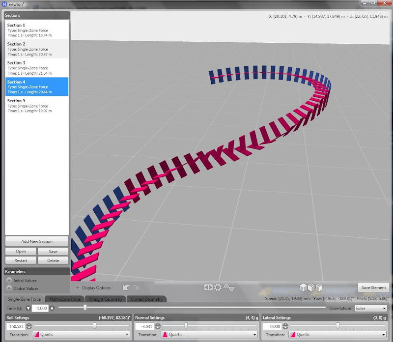

Post September 28th, 2009, 12:10 am
Posts: 5268
I think its easier and more effective in the multi-zone to have the G's change over the apex or middle of the turn using a force segment with a sextic transition that matches your G's (or exceeds) that you entered with. That way youll have airtime of at least 0.0 between the twisting motion.

Post September 28th, 2009, 9:42 am
Posts: 5268
yea it worked real nice first time I tried it. If I ever need a twisting transition with airtime I use that method. I have much greater control and G's are great.
Heres a shot. I copied and blew up my roll and g settings (dont need the lateral) so you can see whats going on. I should have made the overall segment longer but thats a moot point. The red and blue time zones highlighted represent the twisting action between the turns.
