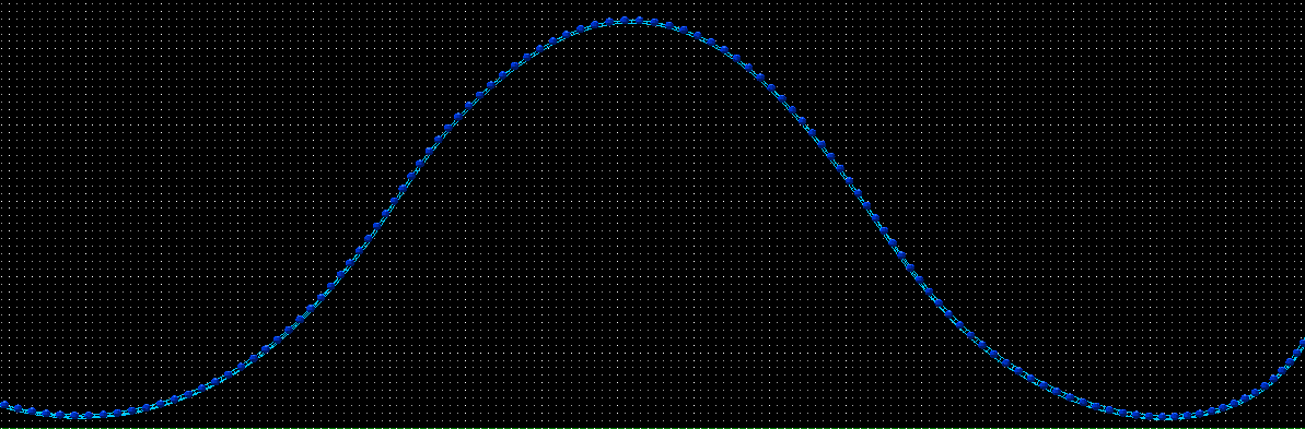

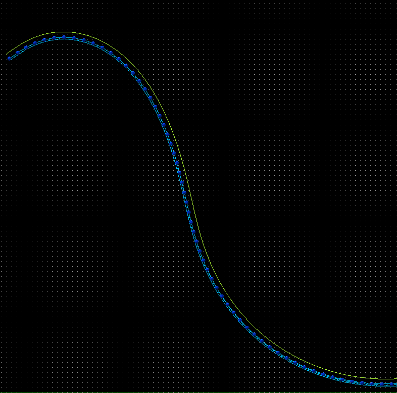

Can you post a pic of your drop and air hills from the side? I wanna check the shaping.

Yes I have perfect shaping already. But sure.

Here are the pictures. The Drop has a 75 Degree plummet, and the hills are 55 Degrees or lower.
Drop:
20.17 KB
Hill:
18.26 KB

I think your hills are a little wide. The older hills maybe, but the newer hills like on Diamondback are a little tighter, a lot more airtime.

Your first drop does not have 'perfect shaping,' plus what Real said.

How much tighter Real in meters or feet? And, DC's I matched the shaping to the picture and it is correct shaping.

What picture? A picture isnt such a great guide. It can only give you so much information. If you had say, a blueprint with a sideview thats NOT taken with a camera lens which bows the image, then I could believe you when you say it matches a picture. Otherwise, Ill just say because you matched to a picture taken with a camera its going to be wrong from the get go.
I dont know, I would judge it based on forces and multiple pictures, not just a picture.
Be careful using images. Camera lenses bend pictures no matter what. Even a 400mm zoom is going to not eliminate that effect.
Second, unless the picture is taken EXACTLY from perpendicular and also far enough away as well as at the right height youll be off.

The picture was perpendicular. Also, I rode many POV's and it feels like the drop.

mathematically its perpendicular? Is it also the proper distance to avoid any distortion vertically or horizontally? is it taken from the right height? If the hill is some 230ft, then the picture would need to be taken at roughly the middle point.
Point is, you dont have a picture that meets all that criteria. No one ever does unless they have a blueprint which has NO distortion. Claiming its perfect from a picture is like me claiming im taller than Millennium Force just because the picture is taken very close to me, from below so distortion and perspective screws it up. Come on man, even POV's and riding it doesnt give you enough information.
If somehow you got blueprints from B&M, then Id believe you. But even then, replicating their designs is still crazy hard.

So what do you suggest?

I think for sure your lead in from the lift to the top of the hill is way too long. I think you said you were using Newton for that part? You probably cant replicate it with Newton.
In my experience using video and every resource it looks like all the crests of their hills for ALL rides snap with a quick transition (but not without a lead) to a static radius. From there, the speed and angle determine the pull outs length and desired G Forces.
It looks good, but probably isnt perfect.

^ Why thank you. And to me, that drop is not perfect, the pull up I feel needs to be lower down in order to create as much airtime as possible.
