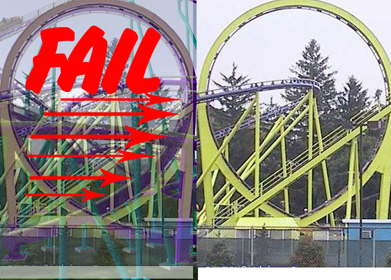

How am I pwned? It's totally off
Edit: This image was created by Oscar and is a defining example of why pissing him off leads to bad things.
90.91 KB
Post September 20th, 2009, 9:32 pm
Posts: 382
The two pics aren't at exactly at the same angle, so of course there will be some difference. I'm not going to discuss this furthur, by allowing my WIP thread to be hijacked by your non-constructive ego-masturbation.

Then why'd you use them to compare if they aren't accurate?
You asked for and you shall receive. Here is the most constructive criticism you'll get from anyone on this site and you better be happy you're getting it.
1. Your drop has like 4 sections to it, it should be fluid. I can see what you're going for and I've never been able to pull it off myself but I know it ain't right by looking at it.
2. Your loop entrance/exit looks too "nice" and drawn out. or you squashed the top of the loop. Come to think of it the first 3/4 of it may be fine but it may be ruined by a crap exit.
3. Super heartlined immelman. You seriously put that on this sucker?
Honestly you've just built an Intamin shaping wise with a funky loop. Can't you see that?

Ok, its not as good as i thought. Your loop is nasy, no offense, just criticism. It is squished down on the top. Also, im not too sure about that drop, its kinda rough. I think u should take a little more time to mess with newton before you go and make a coaster with it.

Well, if we examine the loop element, we see that its radius of curvature is a bit pumpy. The radius is smallest at the 3 and 9 o'clock positions, but becomes larger at the 12 o'clock position. If you notice in the photo of the real loop, the radius is almost constant in the top half of the loop. The radius fins in newton2 (display settings) were designed to aid in situations like this (you can thank the beta testers such as dcs211 for that request). If you haven't seen it already, I'd suggest watching my loop tutorial where I discuss this very issue.

Entrophy... I actually went in and measured the raidus using AHG. At the vertical points it's 7.25m, and at the top it's 6.9m.

Its funny because Ive been using Radius fins (on the full construction kit) for years now so thats just second nature to me. lol.
Its your entrance and exit points Tyler. They should be lower, producing a more circular shape.
