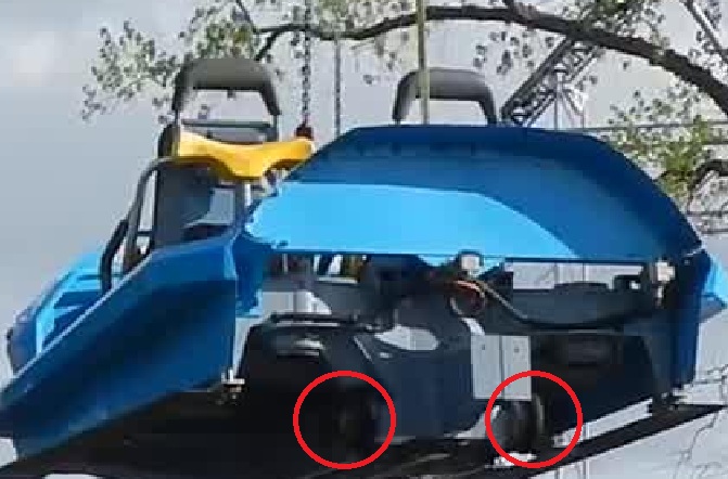

I can't find a good picture, so I'll try and run over to MF and take a pic this week.
They're on almost every car; however you can only see them from the back of the last car. Next time you're approaching the load station, look at the back of the train. You'll see 2 rubber black wheels. These wheels are attached to the Anti Roll Back (ARB) system. They make contact with a portion of the lift. Once the rubber wheels are spinning forward, the ARBs are lifted. As soon as the wheels slow (in other words, the train slows) or the wheels roll in reverse, the ARB are dropped.
EDIT:
I found a pic:

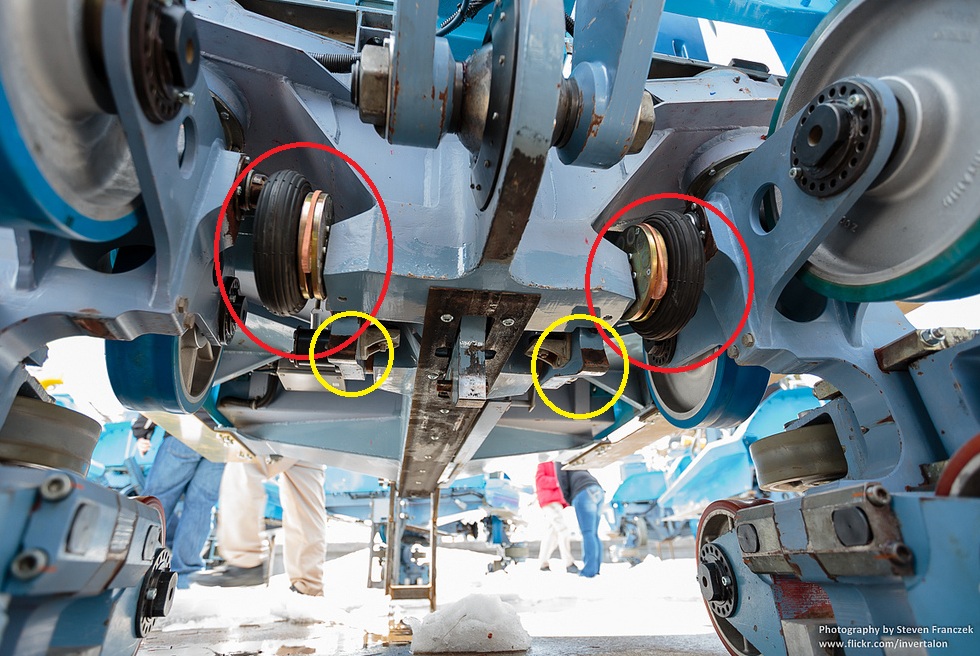

After a quick search, I found a great pick from someone on FLICKR from Winter Chillout event.
You can see the whole system in this shot.
https://www.flickr.com/photos/invertalo ... 1377834953
EDIT:
Credit for the photo goes to Invertalon on FLICKR
Red Circles: Friction Wheels
Yellow Circles: Chain Dogs
