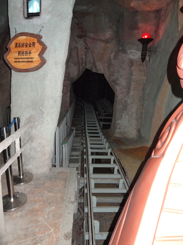

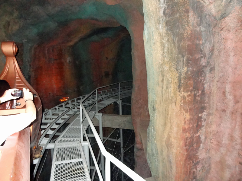

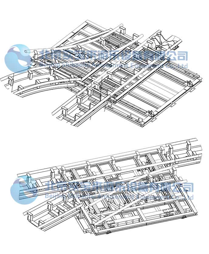

I am trying to recreate the trackstyle of this coaster.
203.96 KB

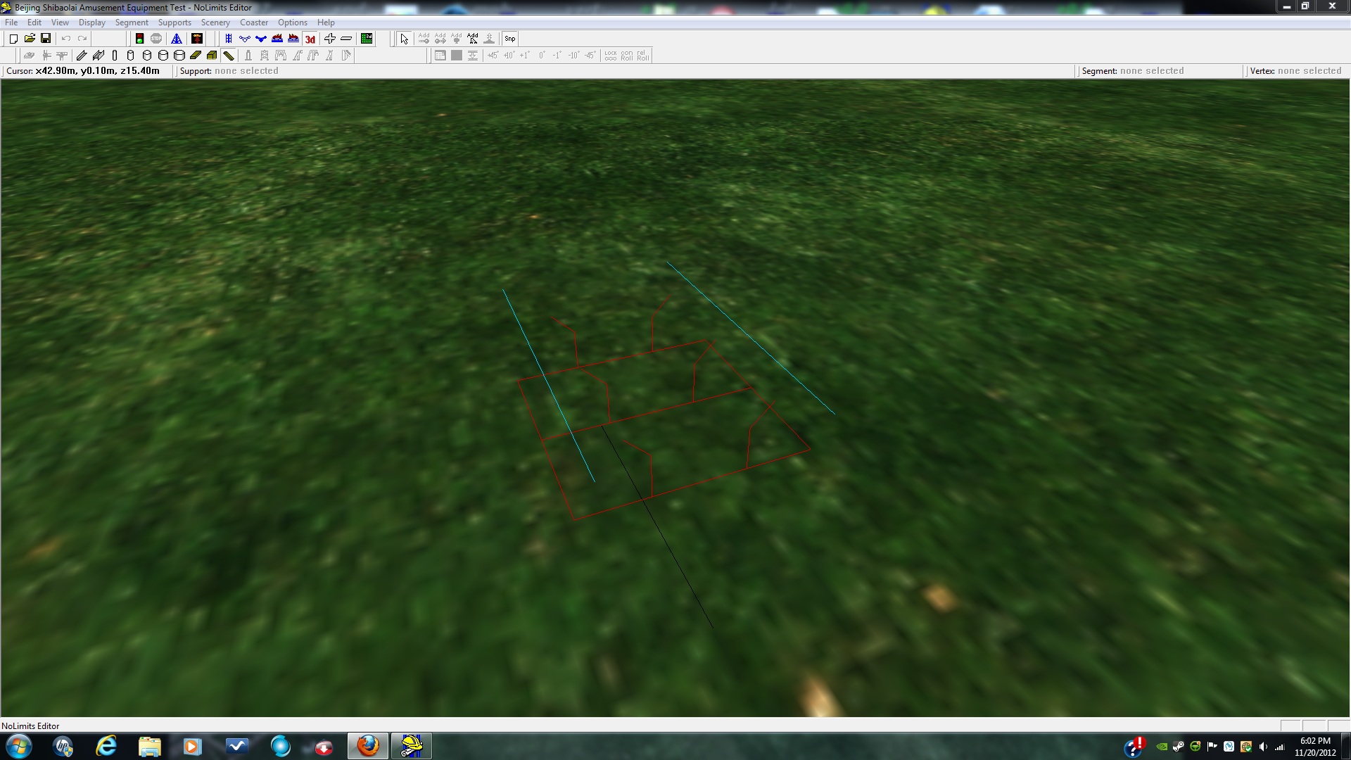

I have made the custom trackstyle by using the Gerstlauer bobsled track and adding free nodes and wooden small beams.
399.35 KB
Can someone help me split the track piece into the smallest equal segments possible so that the ties are hidden? I tried using the editor's split track function but it scrunches up the track when the segments are too small. I also need someone to make a 3ds construction kit model of the three custom ties that I have roughly made with the free nodes. I want to show all of Coastercrazy, that this Chinese track style is possible in No limits.

what coaster type is this, corkscrew? if that's the case, you can get the segments down to 1m, set as transport, hide the device, and the ties will be hidden. if it's not cork, you need to get them down to .5m

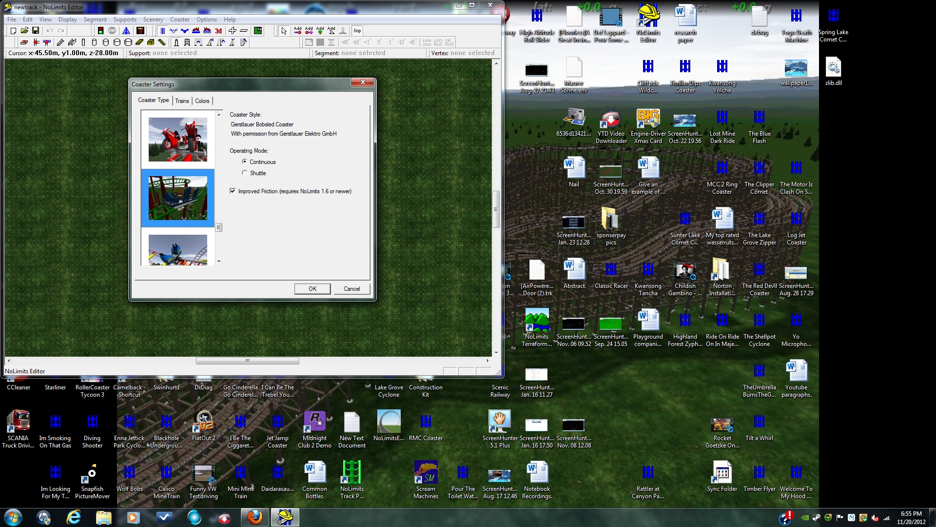

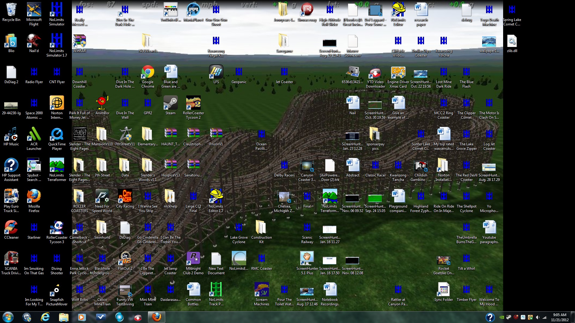

Here is my desktop.
736.69 KB
Post November 21st, 2012, 10:26 am
Posts: 568
I Think its a Really bad habit to put track files on desktop ,Maybe a Folder can helps

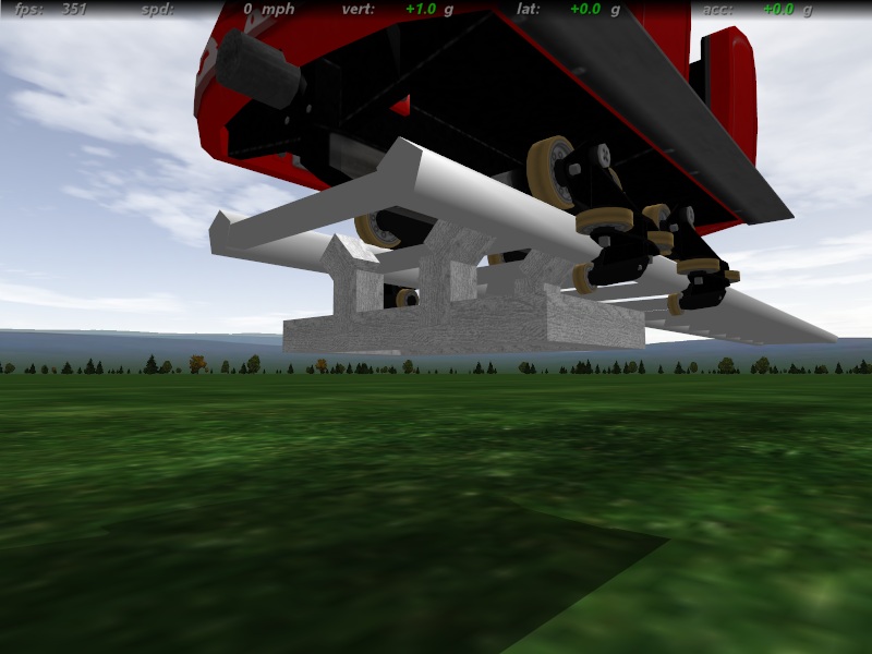

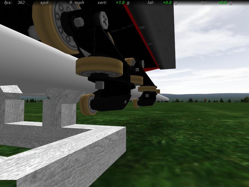

Here is what it look like in the simulator with the wooden supports. The wheels bogies clear the rail supports.
97.34 KB
102.5 KB

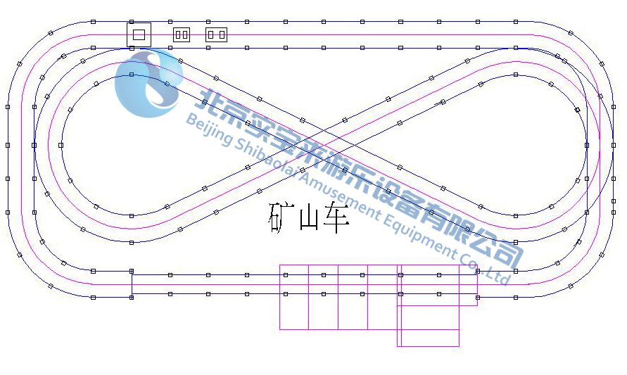

Official Layout Here
372.38 KB
138.89 KB
Post November 22nd, 2012, 10:27 am
It looks like right after the station it has a very small dip, travels straight and then turns to the left, slightly, to the lift. After that it looks like it either go directly to the lift or has a small straight section before hitting the lift. I do not see that in the layout picture above. Where is the lift in the picture?
190.53 KB
