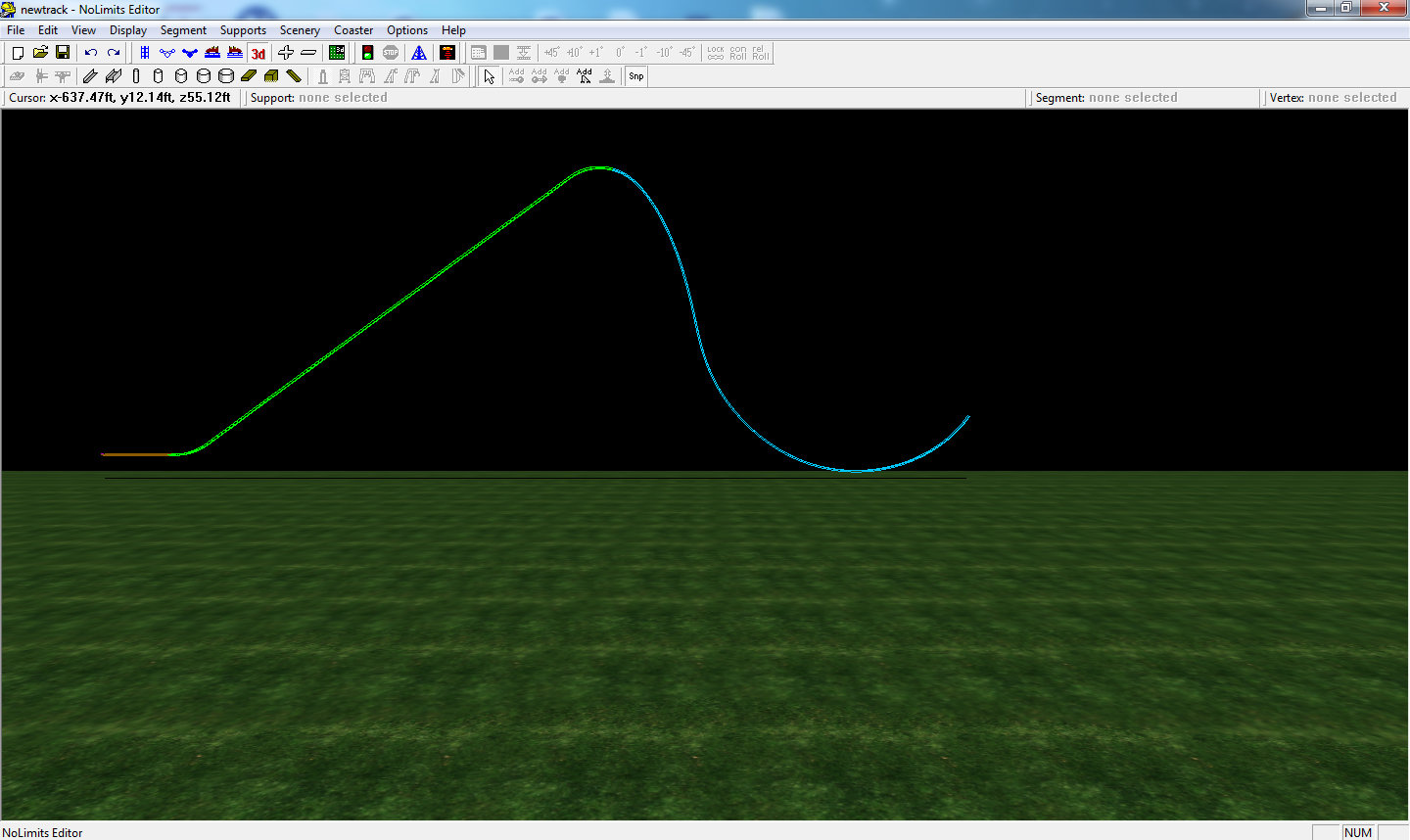

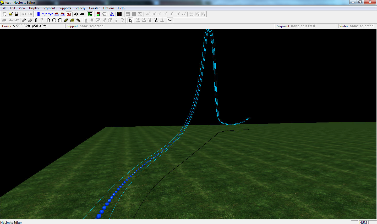

After such a long time without posting and a long time without creating tracks, I have started working on a B&M hyper that I have wanted to build for a while. I have visualized the layout and have the Lift hill and first camelback completed. And Now, I give you...
249.91 KB
Here are some pictures:
156.22 KB
191.11 KB
186.11 KB
137.18 KB
(I dont have pictures in the simulator yet because my graphics card is glitching and im getting a new one)
Tell me what you think!

I like the name. If your going for realistic shaping then you need to work on the drop and the first hill. The transition on the drop is too long, probably because you used curved geometry with a big lead out. The hill needs to have quicker positive to negative transition. If you want me to explain more PM me.
Post November 7th, 2012, 4:19 pm
By 'transition on the drop,' he means the pull-up transition.
Not necessarily. But I know what you mean. It just can't have such a sharp crest. It looks too much like an ejector hill and it needs to have a more clothoid profile, shaped for airtime that remains closer to ejector air. Many B&M hypers, especially lately, are seen with pretty long cresting and pulling-up transitions.

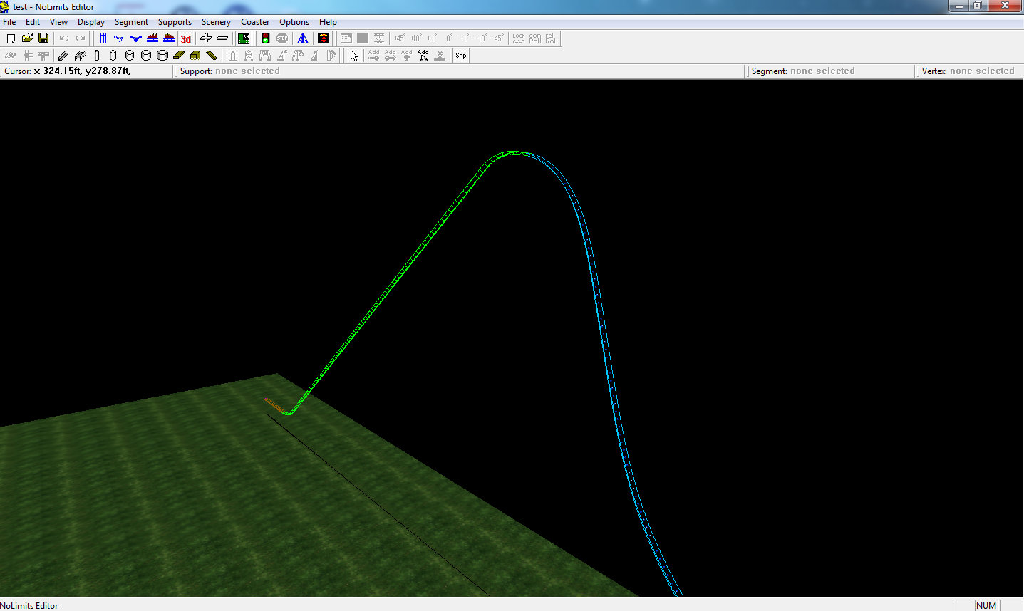

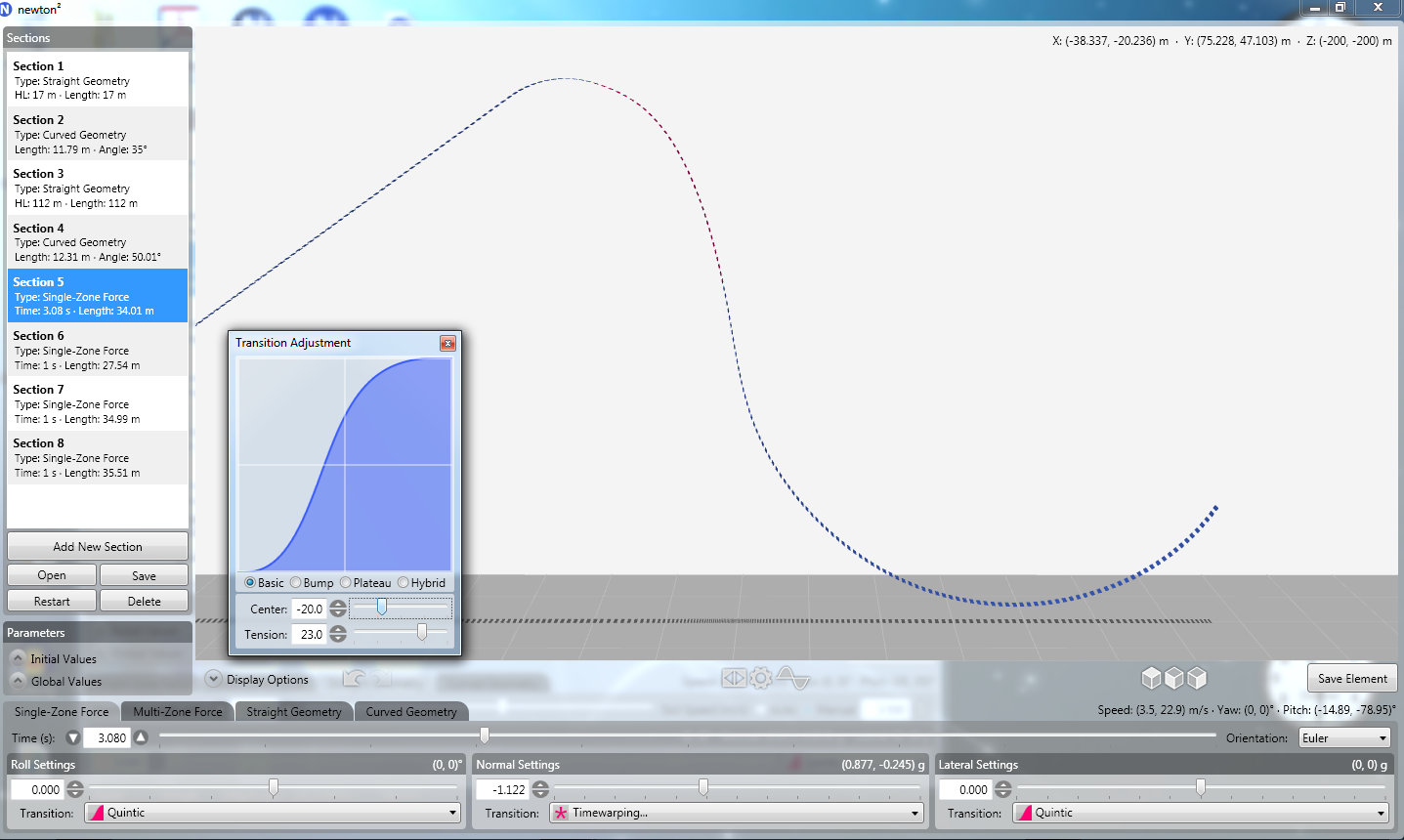

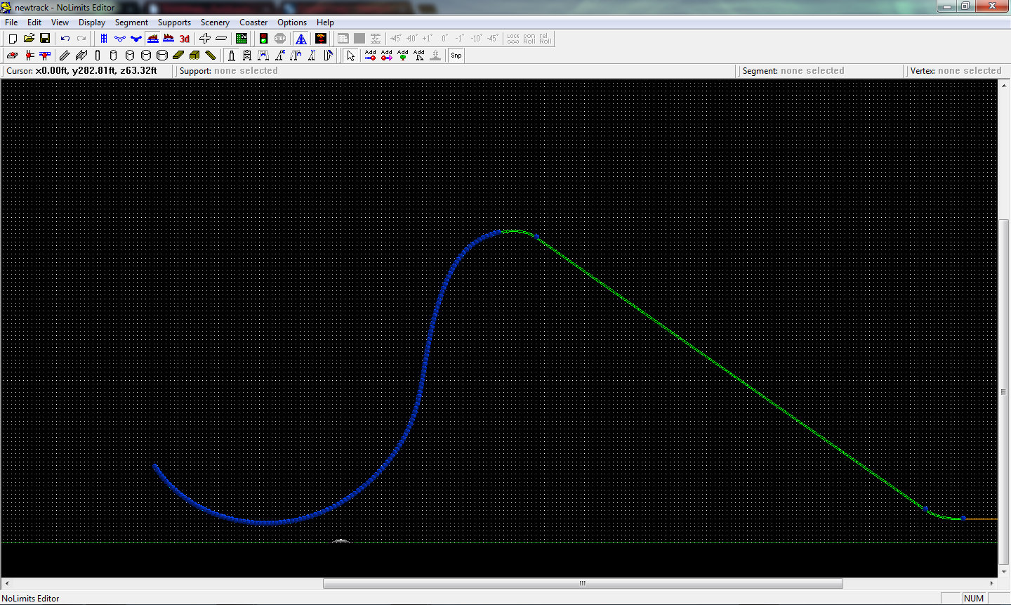

So I re did the lift hill and I think I did not a bad job.
160.19 KB
It looks pretty comparable to THIS:
239.92 KB
Editor Pic:
531.21 KB

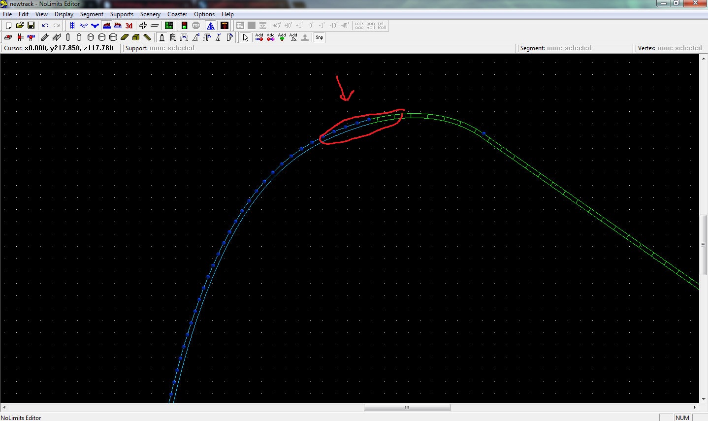

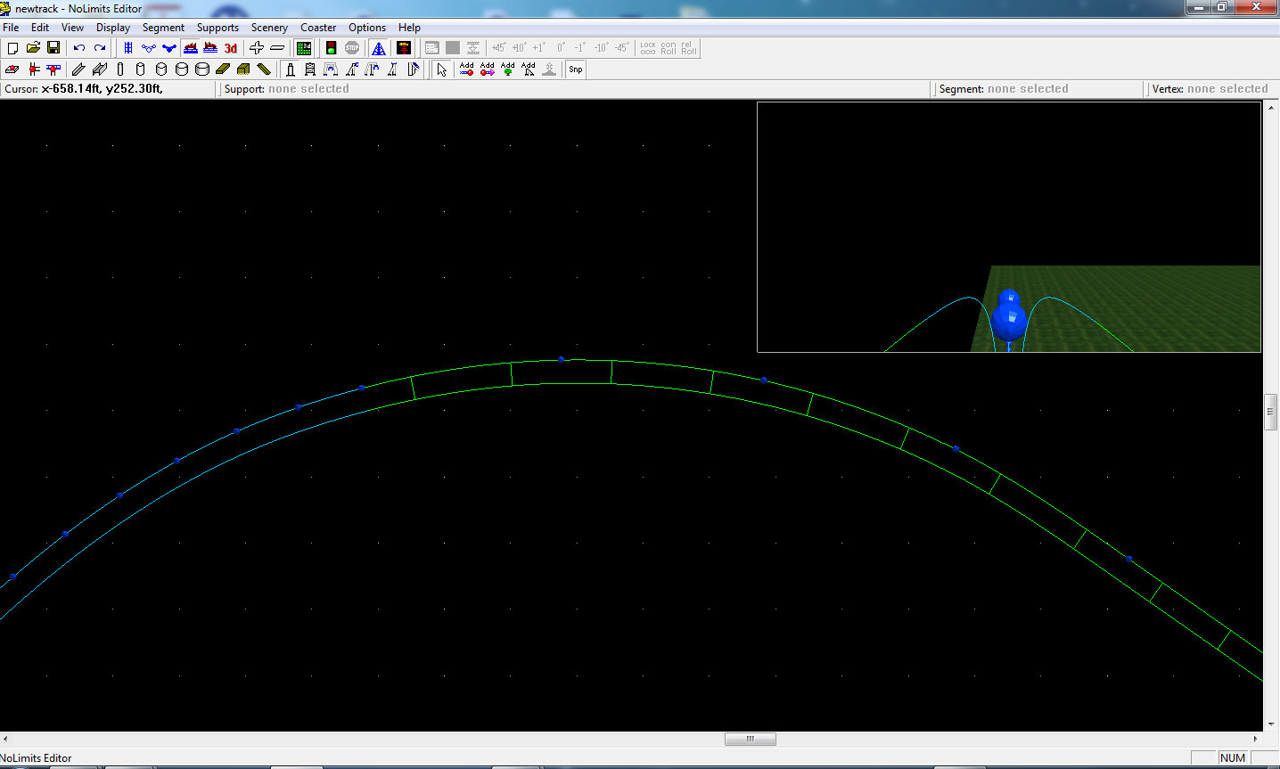

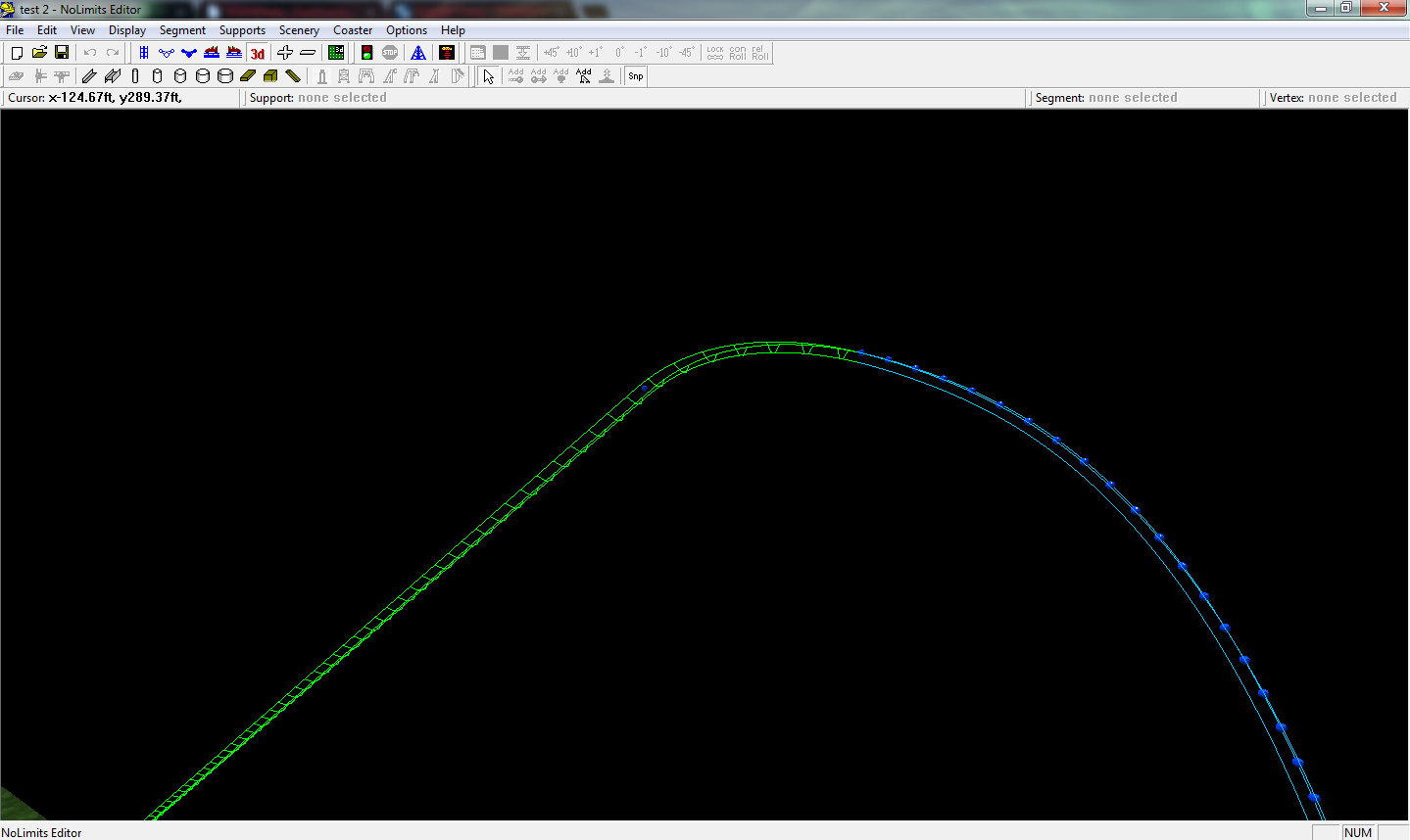

But When I look at the top of the lift hill, I noticed THIS:
194.86 KB
119.34 KB
(^You can see it better in this picture)
Something wrong with the lead in/out? How can I get rid of this?
Post November 8th, 2012, 11:45 pm
Posts: 1027
Points on hand: 92.00 Points
Bank: 1,341.05 Points
What's the radius of the lift crest? Also, export the crest as smaller segments to keep the shape you created in Newton.

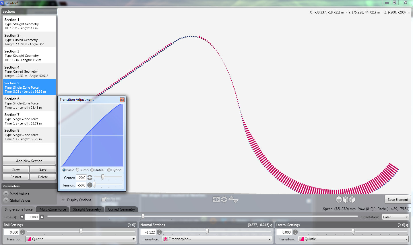

The force transition needs to be more linear. Lower the tension in timewarping screen you posted until you get the right shape. Also make sure the curved segment before has no lead out. That should do it.
Post November 9th, 2012, 10:40 pm
^^ Radius is 14.
Also Modified it a bit. Pics will be up tomorrow.

Instead of trying to run right into a force based zone right after the lift crest, put in another curved piece that leads into the drop a little bit. Also, for a radius of 14, I would go for a lead in of something between 5-10. That should help your crest take shape a little better.

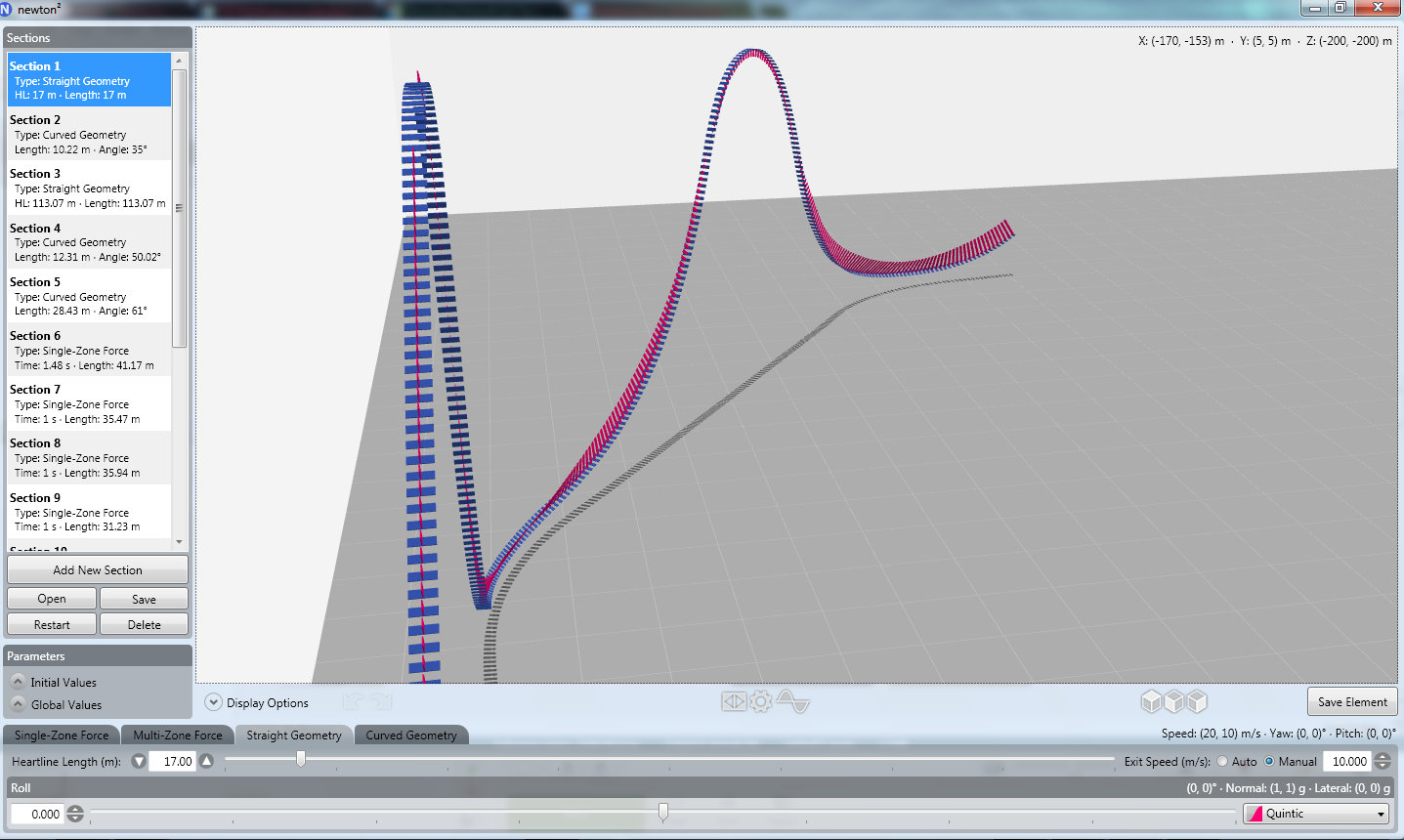

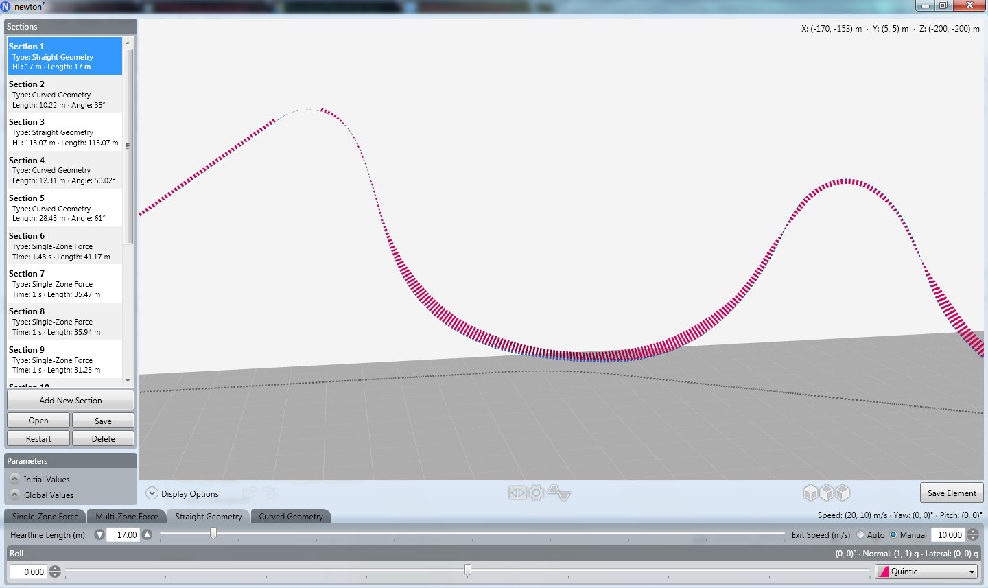

OK I adjusted the tension and got this. What are your thoughts? Ill post pics in the editor later.
165.28 KB
EDIT:
137.26 KB
Im still getting the problem, and im fixing it. I must say, the drop looks great:
179.7 KB
Another view of problem:
108.42 KB
Ive read the responses and will try to use them in fixing this thing.
Post November 15th, 2012, 10:23 pm
Posts: 1027
Try adding a small curved section before you go to the force based zones. If your lift ends at -15 degrees, add one more curved piece that's about 5 degrees. That will help stabilize the shape at the top, and velocity being a little more correct.
Post November 18th, 2012, 6:25 pm
^I tried that and it sorta worked but now my station has to be 17 meters high so that it doesnt go through the ground.
