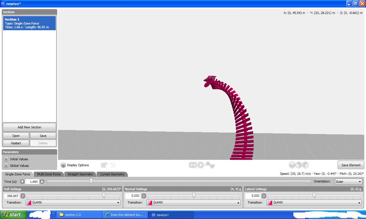

Is this supposed to be a flying coaster?
Post January 26th, 2010, 7:16 pm
Posts: 1240
By the definition of heartline that is not heartlined
I took absolutely no time to shape this, but I am trying to prove a point.
Newton "heartlines" your rides, however, when the correct forces are not involved, the heartline is not straight. Realize that when a perfectly flat heartlined barrel roll is created, there are strong lateral gs on each side. Therefore, when you make the ride have the forces you want the heartline would not be straight.
Perhaps, Vekoma is doing the same thing. Maybe, they want a certain amount of force aplied so they do not make the heartline straight.
Yes, I am aware that there is no relation to the elements we are looking at but the point I am making is that they don't want to heartline it so that they can get the forces they want.
Just a point I thought to throw out there.

Technically, "heartline" is exactly what is sounds: the "line" (in this case, more like the "path") that the rider's heart follows. Generally, it is used to reduce or eliminate lateral G's during banking transitions. It is the point at which NoLimits measures forces in rides, so while a ride may not look "heartlined", it still may be. Observe most B&M inverts' wingovers. The track doesn't appear to rotate around a fixed point below it, but in reality it does. This is sort of hard to get a grasp on, but you have to think of the heartline as the "original" track before it's put into AHG. In my opinion, it's entirely possible that Vekoma SLC's are heartlined, just in a way that we don't expect.
Well, this post didn't turn out as good as I had hoped. Please forgive me for any rambling - I think there's a lot of it in there...

The train stays in a line, thus it is heartlined. That's the prototype model above, and one of the newer supposedly smooth SLC's below it. If anything it looks like they twist their half loops slightly before rolling over and they just twisted it a bit less on the newer designs. If anything I'd call the older SLC's an exercise in bad banking at the most. Ta-daaa.
Post January 27th, 2010, 1:00 pm
My first post was completely wrong then, sorry for the misinformation lol. after that I guess I was just trying to explain that you couldn't have a perfectly straight track spine and still have a heartline...
