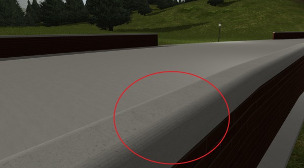

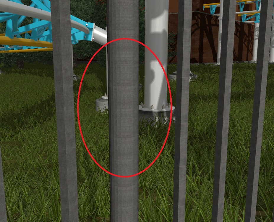

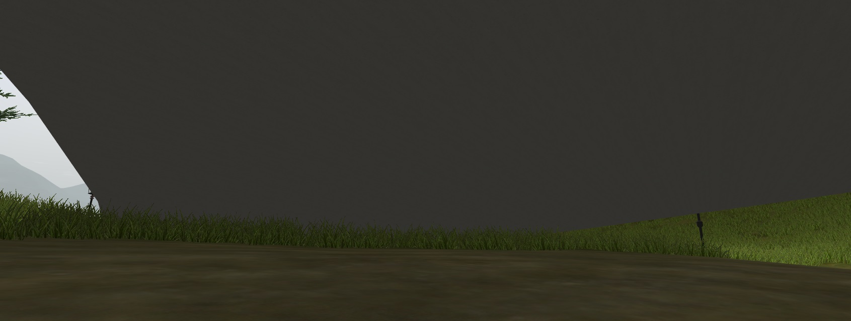

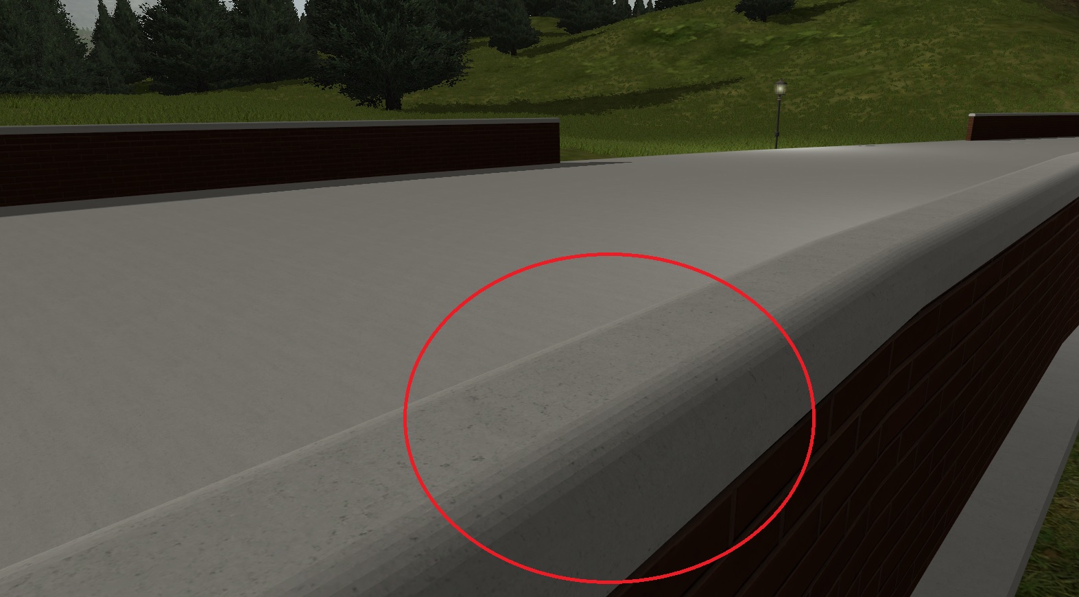

It??s unfortunatly the station which is dropping the fps. Some objects are double sided (both faces are painted instead of one, the outside face). The fence isn??t smoothed and have instead of smoothing too many sides to make it look round.
I like the look of this project but the scenery objects aren??t made for a "simulator/game" ;)
Here are some examples:
This is the heavey part. The round-corner is having many faces to make it round. If you look at the length of your fence and all the round shapes, you can imagine how much faces must be rendered. One single square is having 2 faces/triangles.
Too much faces.

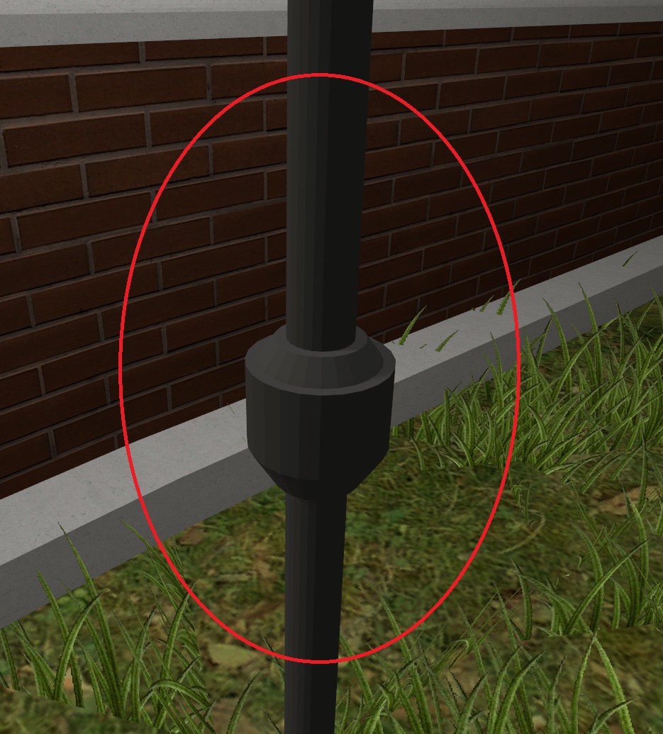

The lamps (and there are much in this park) having too much faces for a simple detail-object like this one.

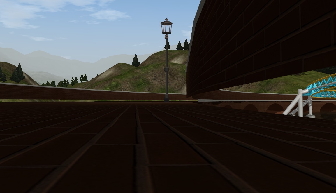

The Path having some un-needed double faces. All other scenery is almost fine with only one side.
Underneath the path, there are some more unseen faces.
