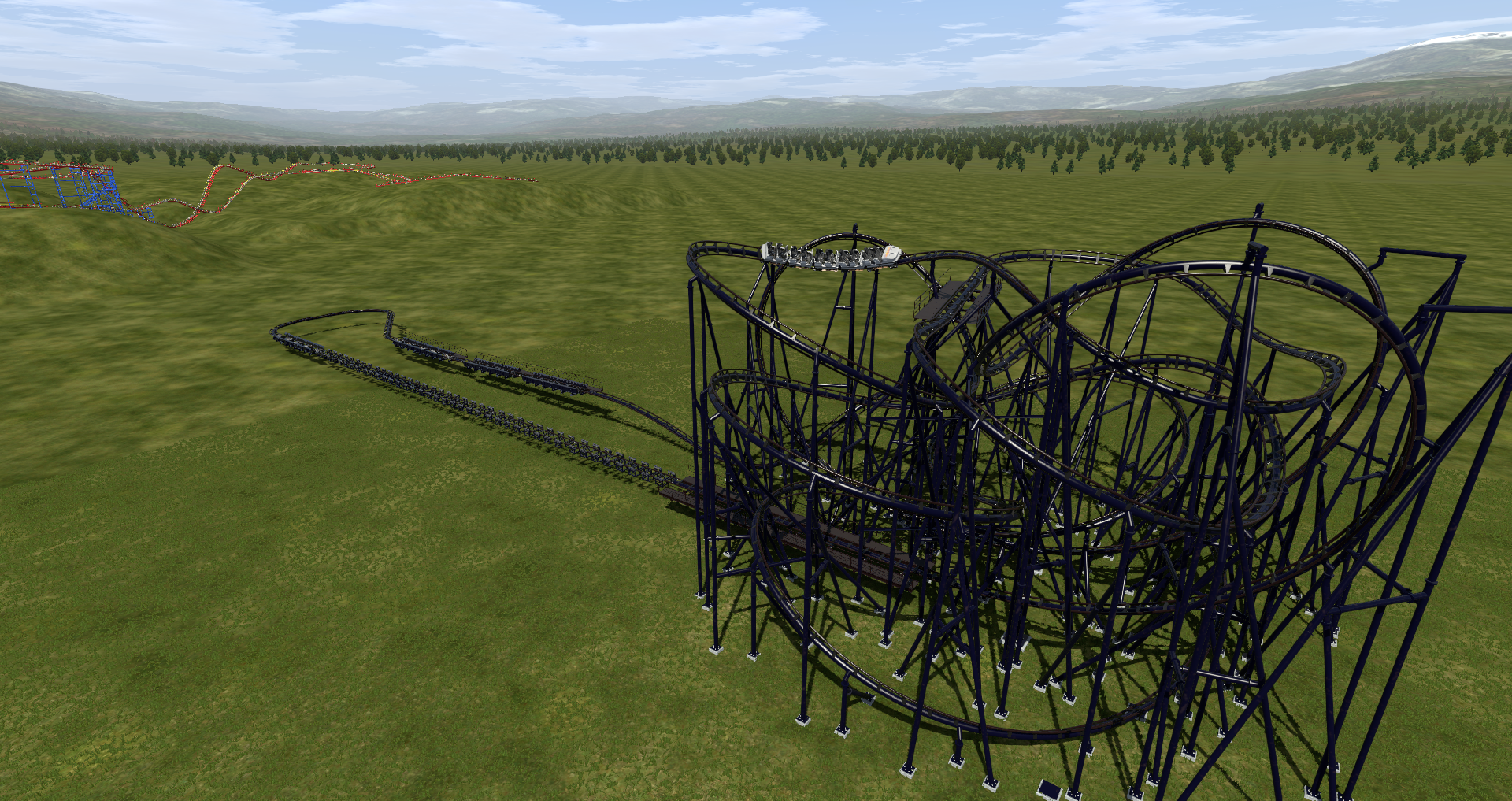

I managed to get it stuck in NL2.
I launched it at 47 MPH.
they have the correct ride type in nl2...

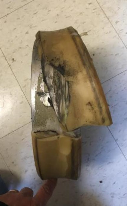

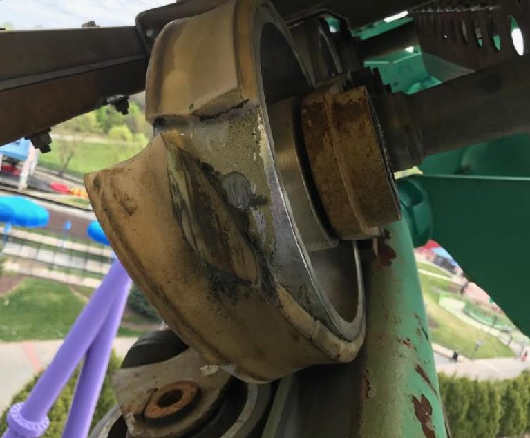

Pictures leaked showing the failure that occurred to cause Jokers Jinx to valley.

I see nothing wrong.
That's a screw up
Posts: 579
Christ almighty that could've actually been a lot worse than it was.
I'd love to know how that happened; it shouldn't be able to happen!
so much rust.
