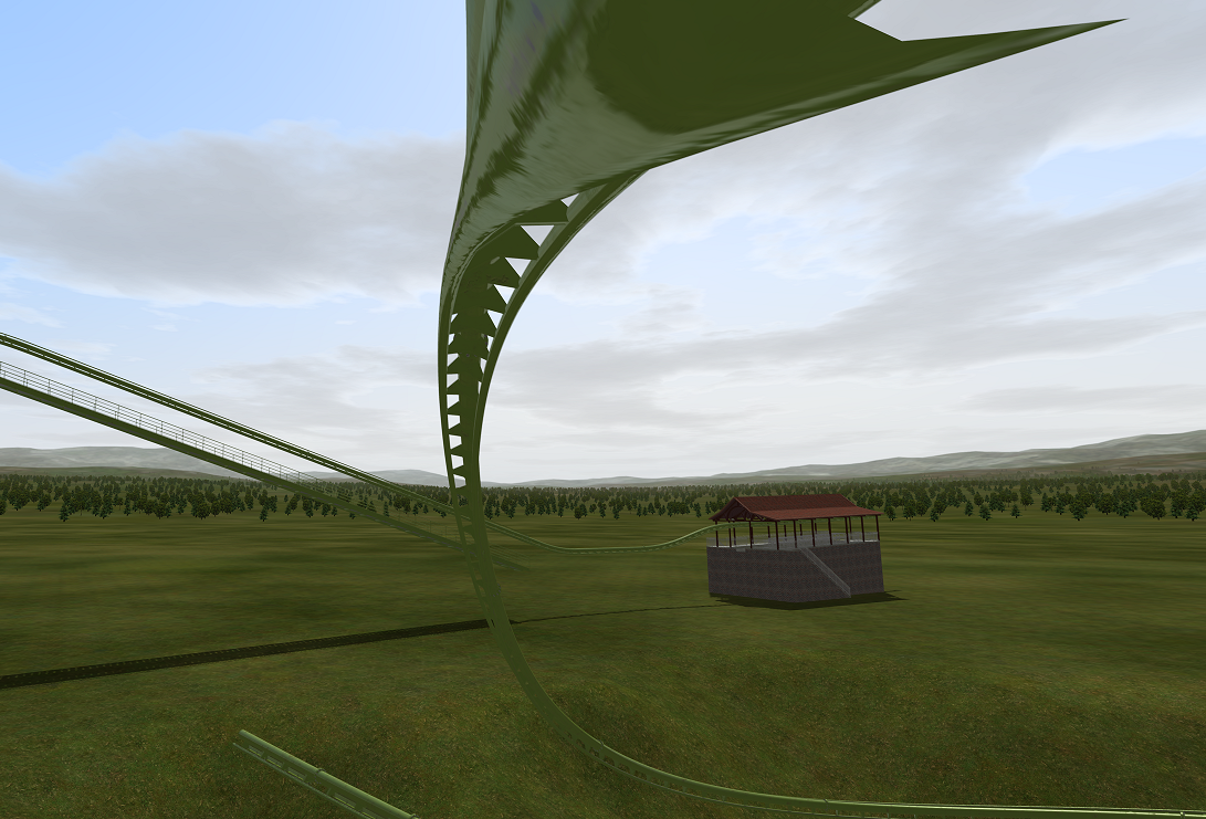

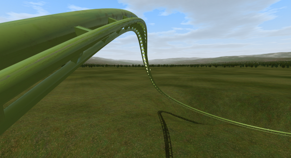

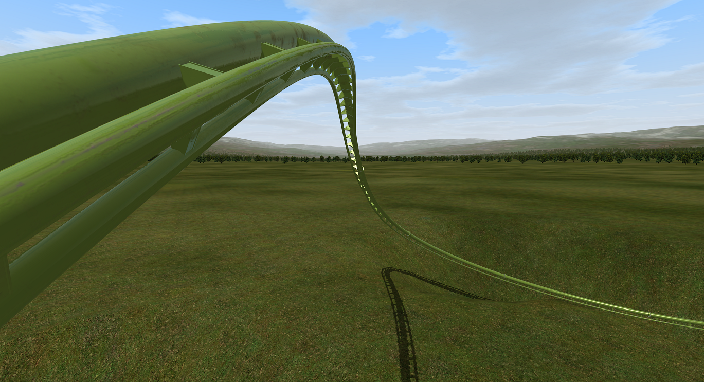

I was working on a suspended coaster earlier and during testing, I noticed a spot where the Gs seemed weird. At first I thought it was just a little wiggly from the swinging, but I had to slow it down to .25 speed in order to see that there are two tiny jolts that are reading around 2+ lats in the back... maybe worse. it happens so quick I don't know what the number is, but it's in the red. It would have been completely unnoticeable if I hadn't slowed it down, although the jerk itself is kinda clear at normal speed... not the Gs.
I really don't know what is causing it! It's a piece of track that happens to have been made with the in-game FVD, it has been further depumped (now many times after noticing the issue), the radius comb looks normal, roll points look basically correct, and the G-force comb doesn't show any spikes even though it happens in the middle of the train too. The track looks perfectly normal when frozen.
Here are some pictures. I know they're not the best but it happens in a really small stretch of track and I was trying to focus in on it, which was not easy.
Any ideas?
