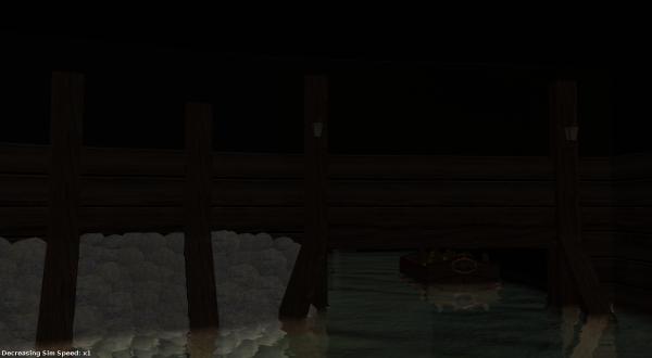

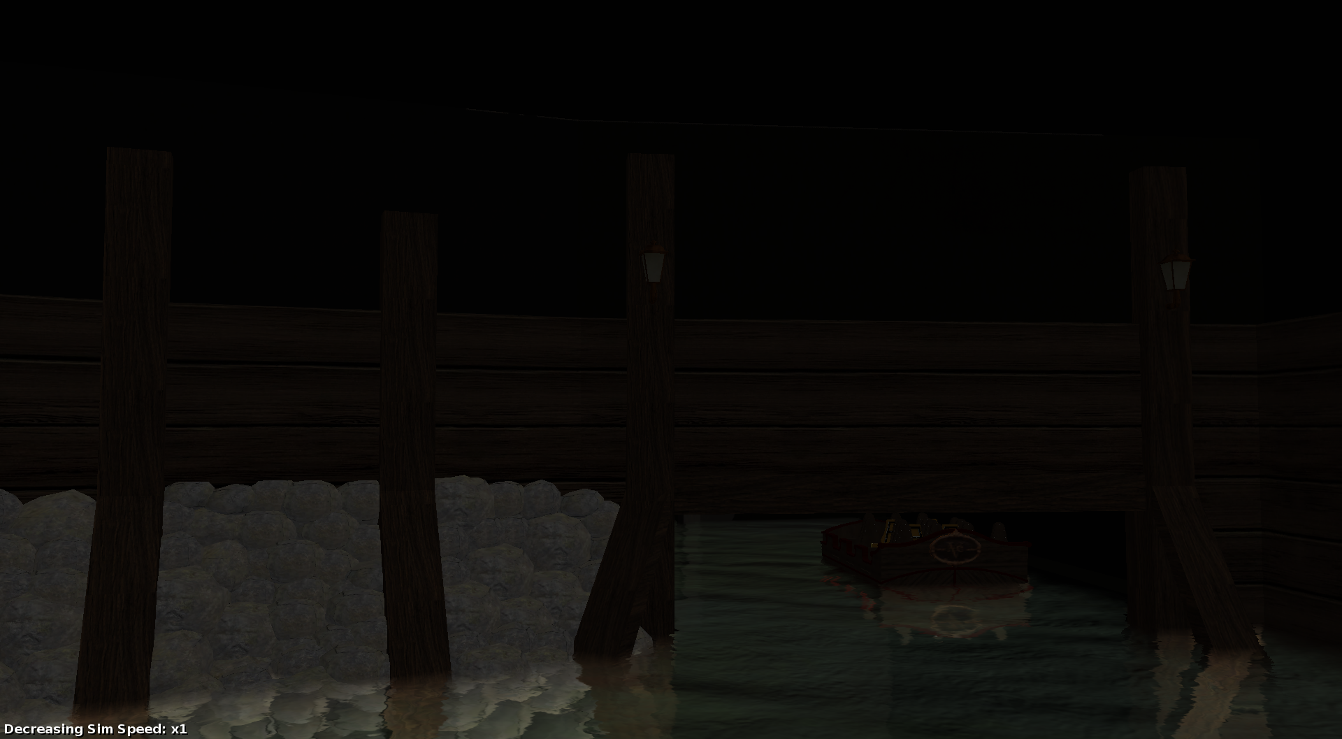

hi i have made a light in the editor and it work when i start the simulation the light don't work who can help me? what is the problem?
in the editor
in the simulation

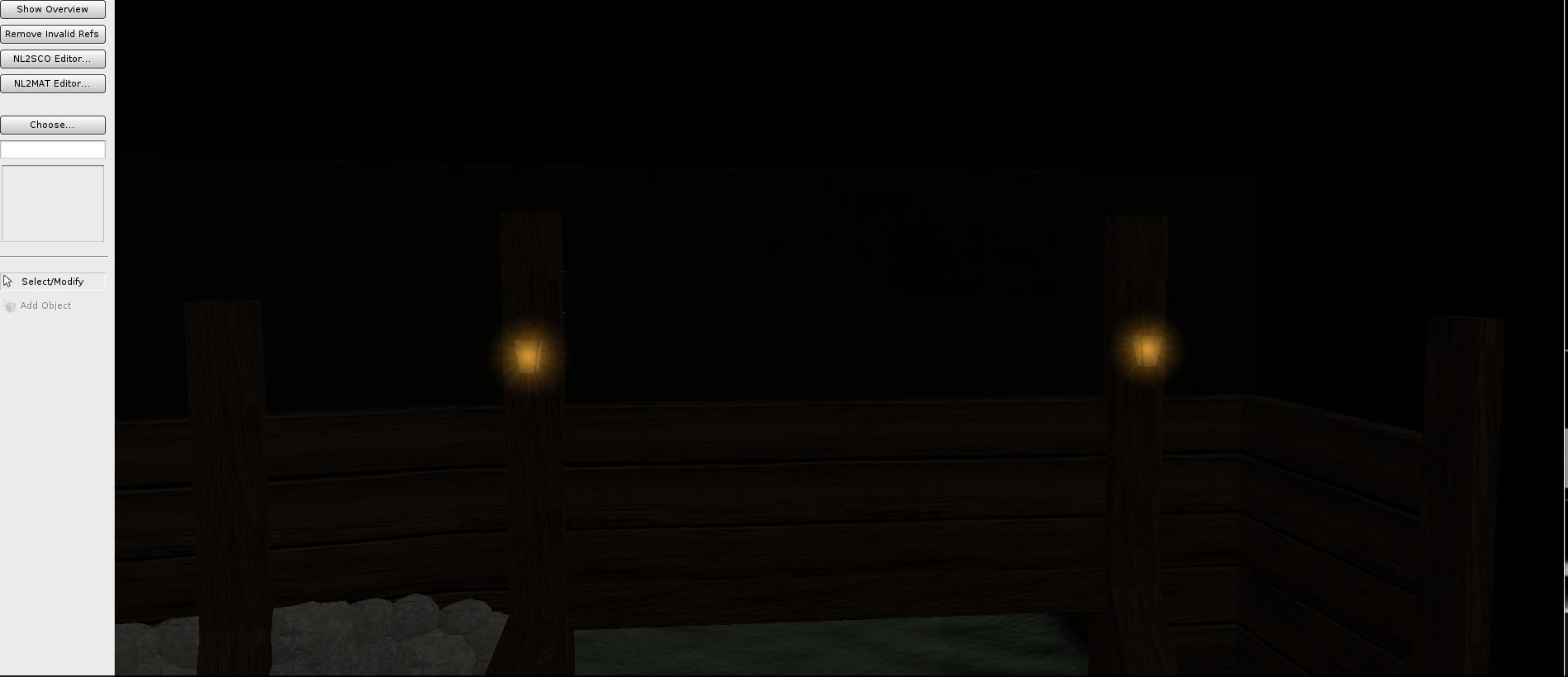

^It might be because it isn't night time

If I remember it correctly, the standard lights have a script which tells the lights when to turn on the lights. Normally the script does this when it's dark outside.
If you want to let the lights burn day and night, you'll have to edit the script. If you use the standard light script you'll find this chunk of code in it:

When you replace it with this code, it should burn constantly:
public void onNextFrame(float tick)
    m_aLight.setEnabled(true);
I haven't tested this code so maybe you should still edit something but I think this should work.

Thank you ??? it works
