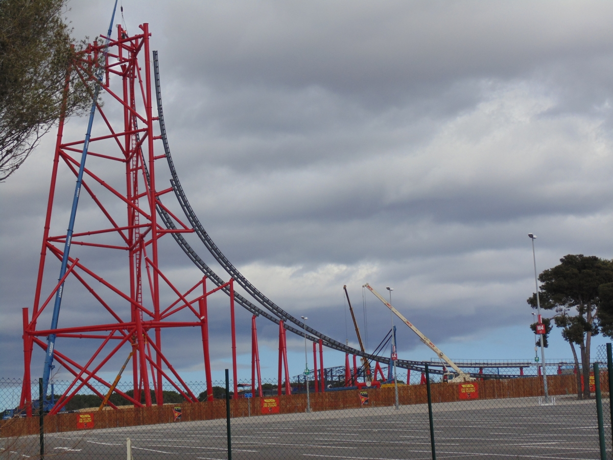

That wobble worries me.

So is anyone going to address what's going on with that straight section before the "airtime" hill? :?

It's a section of brakes. I bet you'll get a nice pop going into the real brakes after it. Honestly it's a smart way to add a few feet to the drop height of the ride.

AAAAAAHHHHH God intamin what are those wobbles!?!

@coasterkidmwm I know that they're trim brakes lol, I was referencing the question to why it looks bumpy the way it does?

Looks like they are probably bent due to load sagging instead of part of the manufacturing process, if somebody ran it through the bender with a few degrees of pitch on accident the pins wouldn't line up. Maybe it happened during shipping? Usually straight pieces are sent in a single container one stacked onto another. If somebody put a curve down and then stacked several of the straight pieces on it you could probably duplicate bends like that with the weights involved.

I was going to say it looks like they're all sagging in the middle. They'll find it during testing lol.

Ew that's really strange. I wonder how they will correct it.
Any theory as to why they use 2-tube track for things like that? There are so many supports, it can't be cost-effective. Reference Ride of Steel's giant low-ground helix. Shipping? In this scenario I feel like if it were 3- or 4-tube or new-single-spine track there wouldn't be deformations in the rails.
Lol at the random really short double-spine sections. I know those are the highest stress areas of the structure but it just looks funny to me.

With the brake run, it looks like each track section has bowed after sitting on the wooden blocks in the parking lot.

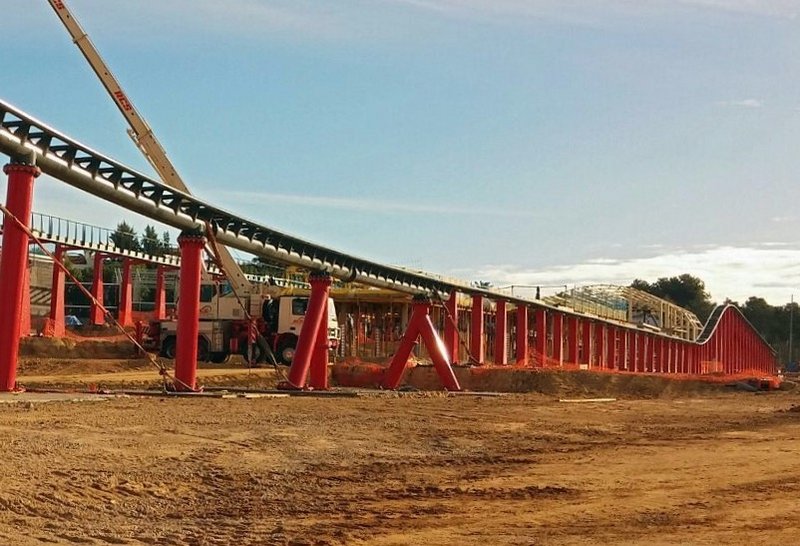

Is that the only picture we have of those 'wobbles'?
What if those wobbles are just an illusion because of the heat, just an idea.

The track in the middle of the screen can be seen bowed inwards
You can also make out the bendiness in the track in this shot

Thanks for showing that, this could indeed be a problem :S
