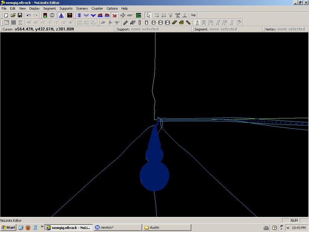

I've been messing around with the settings, but can't seem to get it to stop jerking like this. I've made sure it's quaternion, and the twist is a straight section.

even tho I don't use Newton. I remember reading somewhere to not use perfect vertical pieces of track, but just one degree off. Like 89????????? going up.

Yhea, perfectly vertical pieces make the track yank around the heartline. Thats why i dont like using newton for inversions.

^? An inversion and a perfectly vertical vertex placed without rel roll on are two different things plus what does this all have to do with Newton anyways?
Maybe that helps
Exactly, Banking can't be calculated when using vertical segments without relative rolling enabled and AHG plus Newton doesn't export with with rel roll on. You need to build the track close to vertical but not exact.

And considering that all pullouts and pullins on rocket rides start before the vertical section of the tophat, it would not be far from real-life even if you started your pullout/in at the 85* degree mark.
