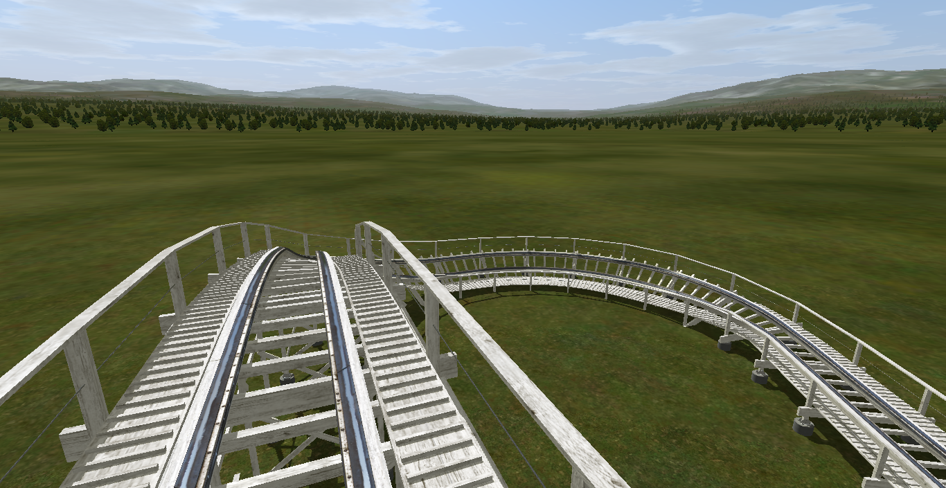

I was going to tell you the exit looks a bit steep (which makes it look too thin) but you already figured that out :D
Post January 27th, 2016, 2:11 pm
Posts: 111
Points on hand: 2,072.00 Points
It's almost certainly my fault. I hurried that final section to get it ready for the photos, and it probably explains the remaining red spike, which is also in that hurried section.
Just a note on my corrections: problem spots are always double checked with both the horizontal plan and the layout diagram. Sometimes the correct bent height is in one and not the other, as was the case with bent number 70, the one just before the top of the lift, where the profile gave me the correct figure. Red spikes are always treated as suspicious - some of his rides were severe, but none of them were dangerous as far as I'm aware. The g-force comb goes smoothly into the yellow at the bottom of the first drop and on the downhill side of the fan turn anyway, so there's plenty of positive forces for everyone to enjoy. :)

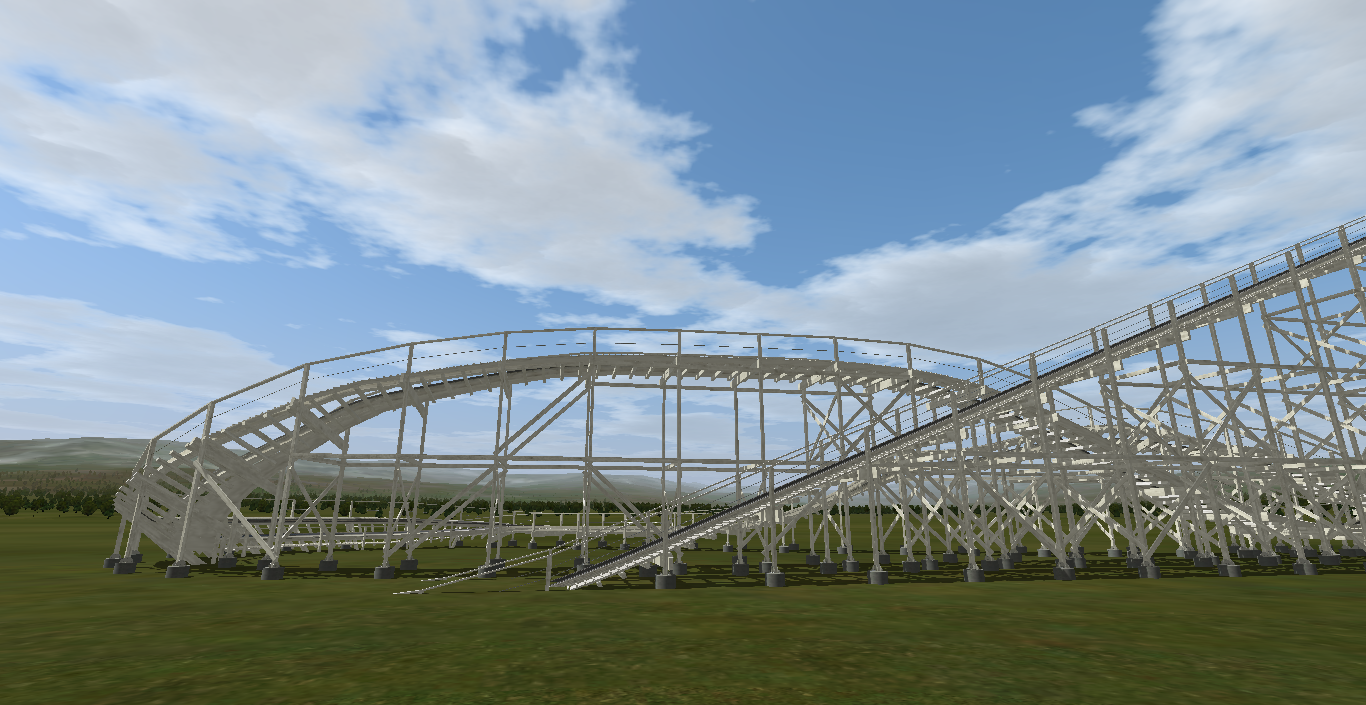

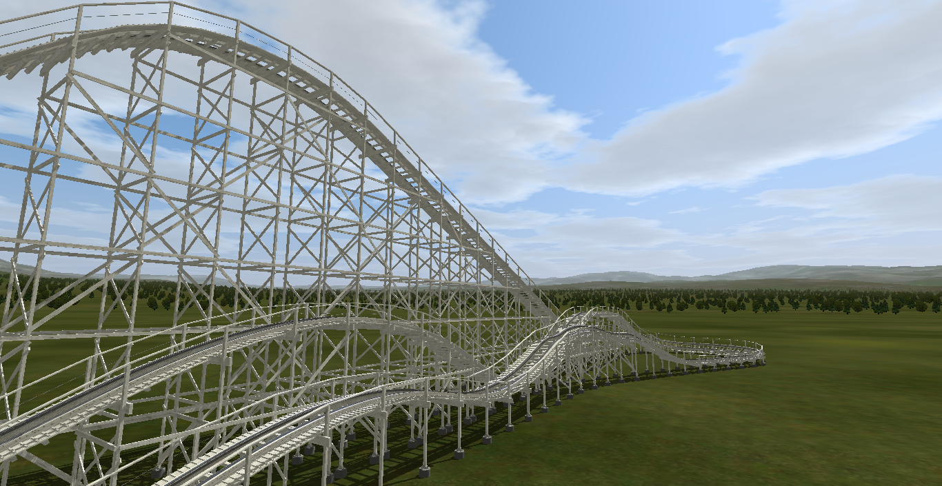

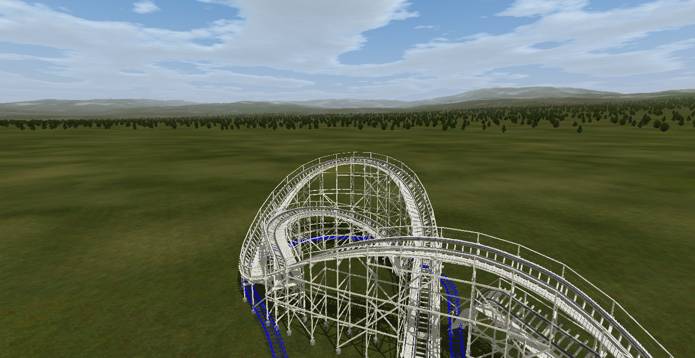

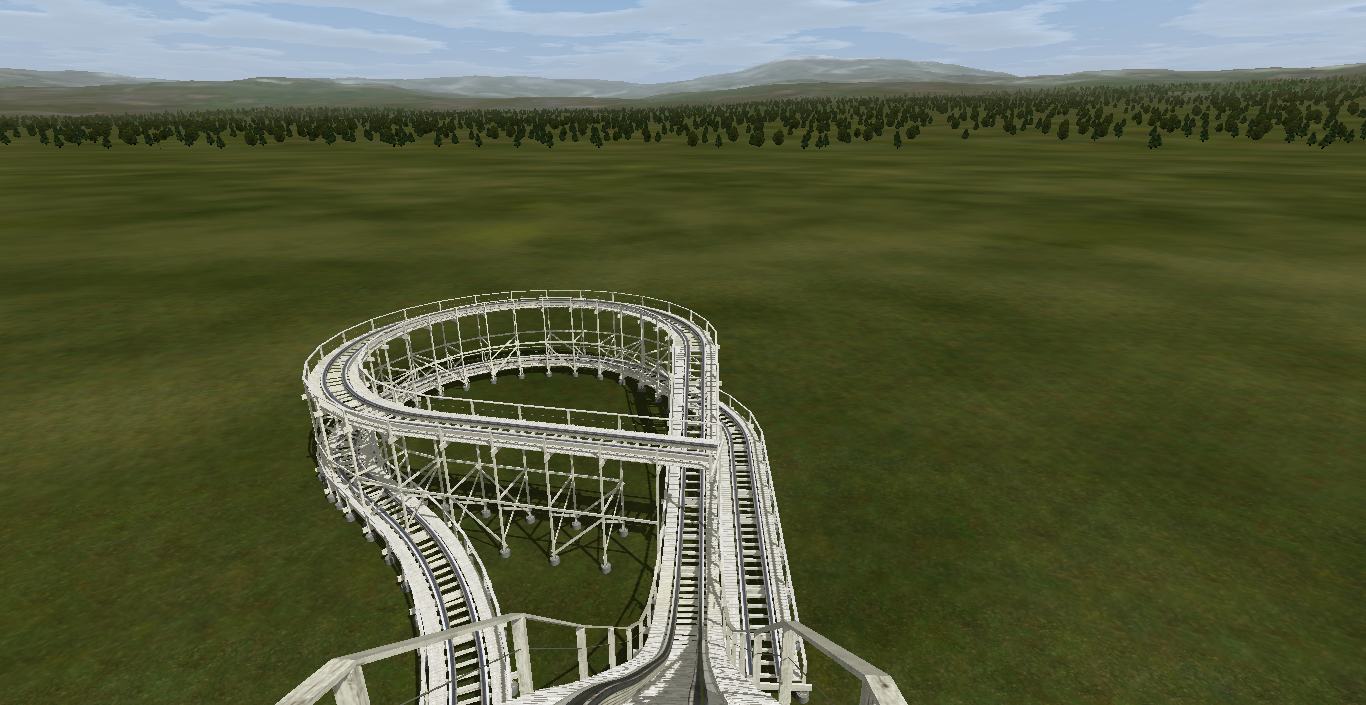

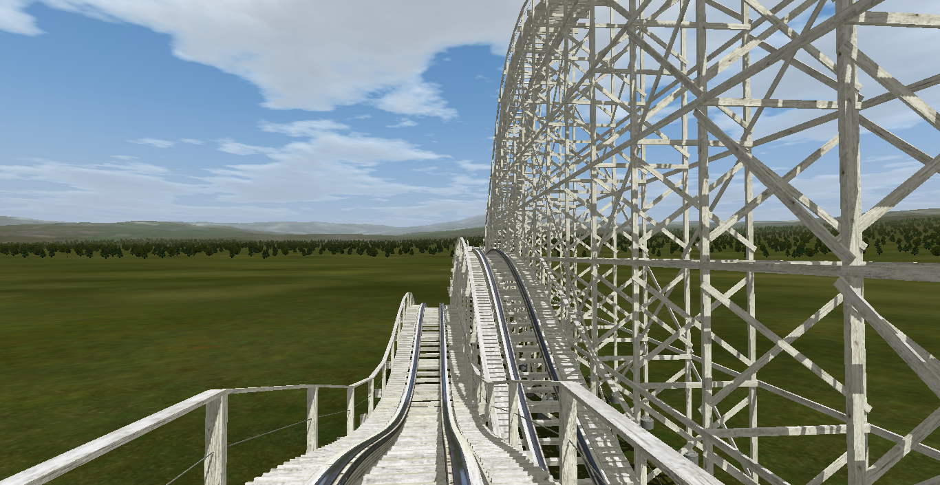

Just a few quick pics showing progress today. The lift hill and first drop is a separate coaster, but I need it there as a reference point while I work my way back to the station. As for the rest, this is the two runs to and from the second midcourse safety block (the high flat) with the lower front turnaround of TA4 in the foreground. As you can see, the game has imposed some interesting kinks in the hill following TA4 which I will remove later, but for now, the main thing is to get all the positional relationships right.
Here's a side-on shot of the midcourse. Normally this view would be visible only from the station:
Taken from the midcourse looking down towards TA4:
Looking back towards where the turnaround 1/3/5 stack would be. I love this shot. :)

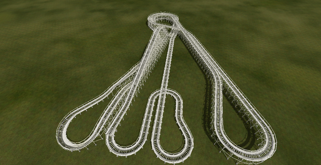

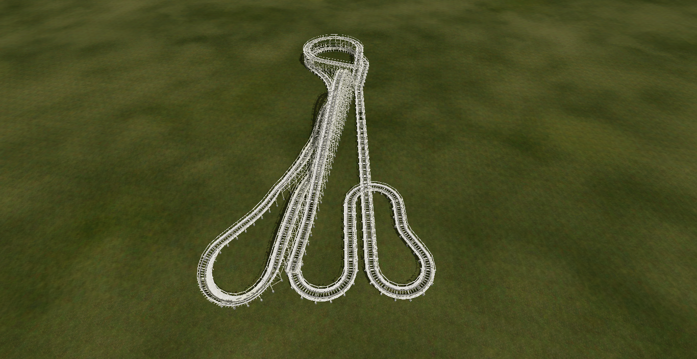

The rough draft now looks pretty good. :) A couple of superfluous nodes need to be removed from the brake run segment, and then I'm going to work on the double station and transfer track, plus a final version of the roll out. I think the two outer curves are 10 feet too close to the start of the lift. Then the lift itself gets replaced, and THEN we tackle the problem of the crossover curve.
Here is the rough look so far:
Post February 8th, 2016, 7:56 am
That's a really odd layout now that I can see the whole thing from above.

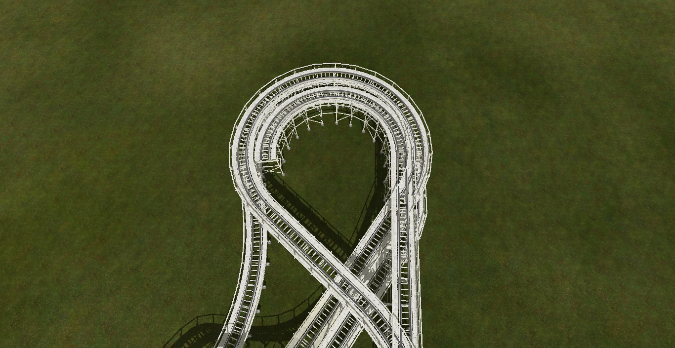

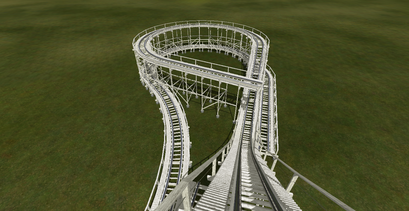

It's too hot to sleep, so I gave the crossover curve one last go. IT'S FIXED! :D And yes, I've saved it. :lol: The problem was the fan turn - for the purposes of the game it has to be 264 degrees. That means that the crossover curve can then have its proper radius as marked on the plan. I've added in the flat versions of courses 1 and 2 following the crossover and you can see how everything now lines up (the gap between TA2 and the roll out is marked on the blueprint). Previously TA2 was too close to the roll out curves.
And here you can see how the inner fan turn of TA3 now fits exactly within the outer fan turn of TA1, exactly as per the blueprint! :D Previously this curve was too far away from TA1 no matter what I tried with the crossover curve.
It is a bit, isn't it? I think Church decided to take the design for one of his pier Giant Dipper coasters (like the Ocean Park/Lick Pier Giant Dipper of 1924 or the Revere Beach Cyclone of 1924) and then open out the lower levels so that they formed wings either side of the lift. On the blueprint it says, "Giant Dipper Plan for Riverview, Chicago Ill" which seems to support this idea. There aren't many aerial photos of the park on the web which show the footprint of the Bobs clearly, but this one will do. You can see the station sandwiched between the two outer turns of TA2 and TA4:

Two things wrong here: the exit of TA3 isn't steep enough and part of that exit goes through the crossover track. I'm probably only a degree out on the TA1 arc measurement. Lesson learned: clearance when flat isn't the same as clearance when banked, but at least it's now recognisable as the Bobs.
