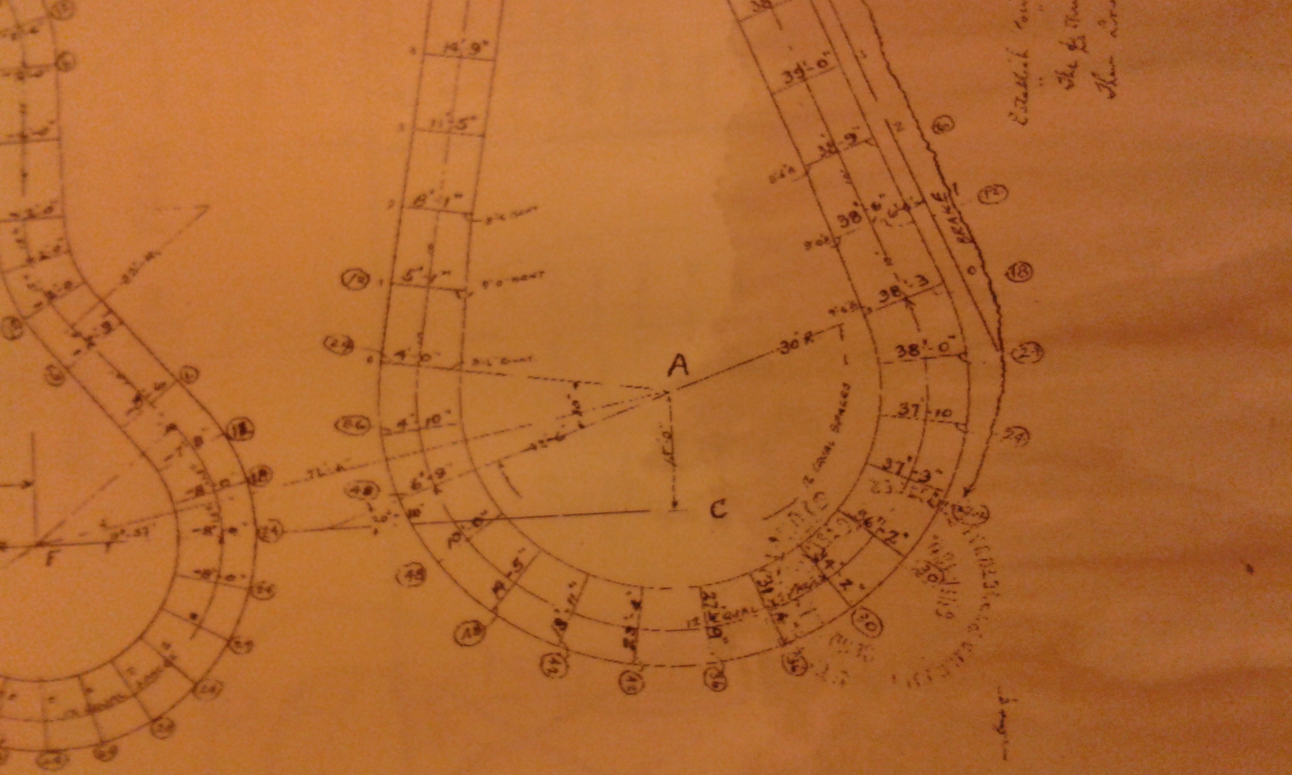

Well, I'm calling it a night. I've been wrestling with FVD++ and I can't seem to get it to do what I need it to do. :(
Attached is a bad photograph of the high front turn (TA2) section of the Riverview Bobs blueprint. As you can see, all along the curve of the turn are height marks where the bents go. The figures in circles are the degrees of banking, and the radius is marked as 30'. In order to create an accurate turn in FVD++ I need to be able to specify the radius, the length of track and the height and bank angles at the start and end. That would enable me to create the turn in stages. The other problem I'm having is with the straight sections where it seems the only thing I can tell it is how long it should be, but not the start or finishing heights. Am I trying to do the impossible? Is there a better way? :?:
Post January 9th, 2016, 9:10 am
Perhaps you could just make the turn the correct angle at the start and then manually move the vertices (Y axis in the editor when you double click them) to get the angles "close-enough" if you have no other alternative.
Post January 9th, 2016, 6:59 pm
Posts: 111
Points on hand: 2,072.00 Points
Thanks. That gave me the idea that going back to Newton 2 was the answer because it allows you to make several 15 degree sections of a curve and adjust them individually to create the overall 180 degree curve you want. I'll have to play around a bit with the roll and direction sliders because apparently roll in my mind does not mean roll in Newton 2's mind; i.e. if I have a 180 degree curve and I set the roll at the start to 45 degrees, Newton 2 rotates the entire curve so the exit is lower in height than the start, as opposed to keeping the entrance and exit heights the same and simply tilting the rider 45 degrees (Church's numbers relate to the angle of the rider).

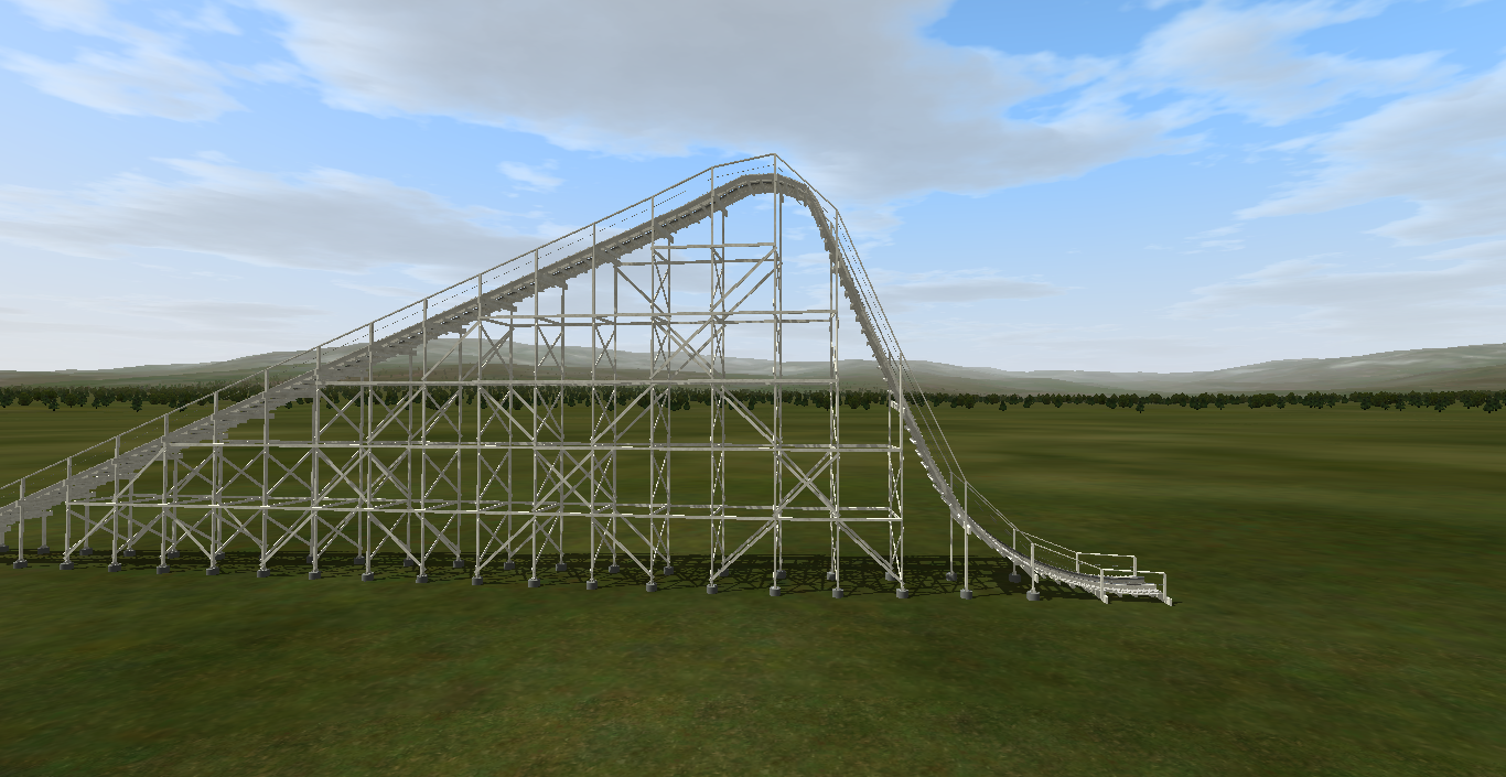

So I had a play to try and get the lift hill and first drop correct and...it didn't go so well. You can see from the photo that the lift crest is completely screwed up and not smooth at all. I'll post about that in the NoLimits forum. The main points though:
1) Vertical Gs did not go into the red. They did reach 4g in the back seat at the bottom of the drop, but I blame this on my bad skills as Church's lift crest, drop and pullout wasn't as steep and would have resulted in gentler forces.
2) The lift hill angle is correct.
3) It was not a tall coaster.
4) Max speed in the sim was 39.6 mph with the lift and friction set to the defaults, but it feels a lot faster. :)
Post January 10th, 2016, 8:11 am
The crest of a lift hill should be about 3 times wider than you shaped. And as for the bottom of this drop you can make that part intense as long as you don't see yellow g's.
Happy recreationing. :)

Yeah lets just say I'm glad you recognize that lift crest isn't right lol.

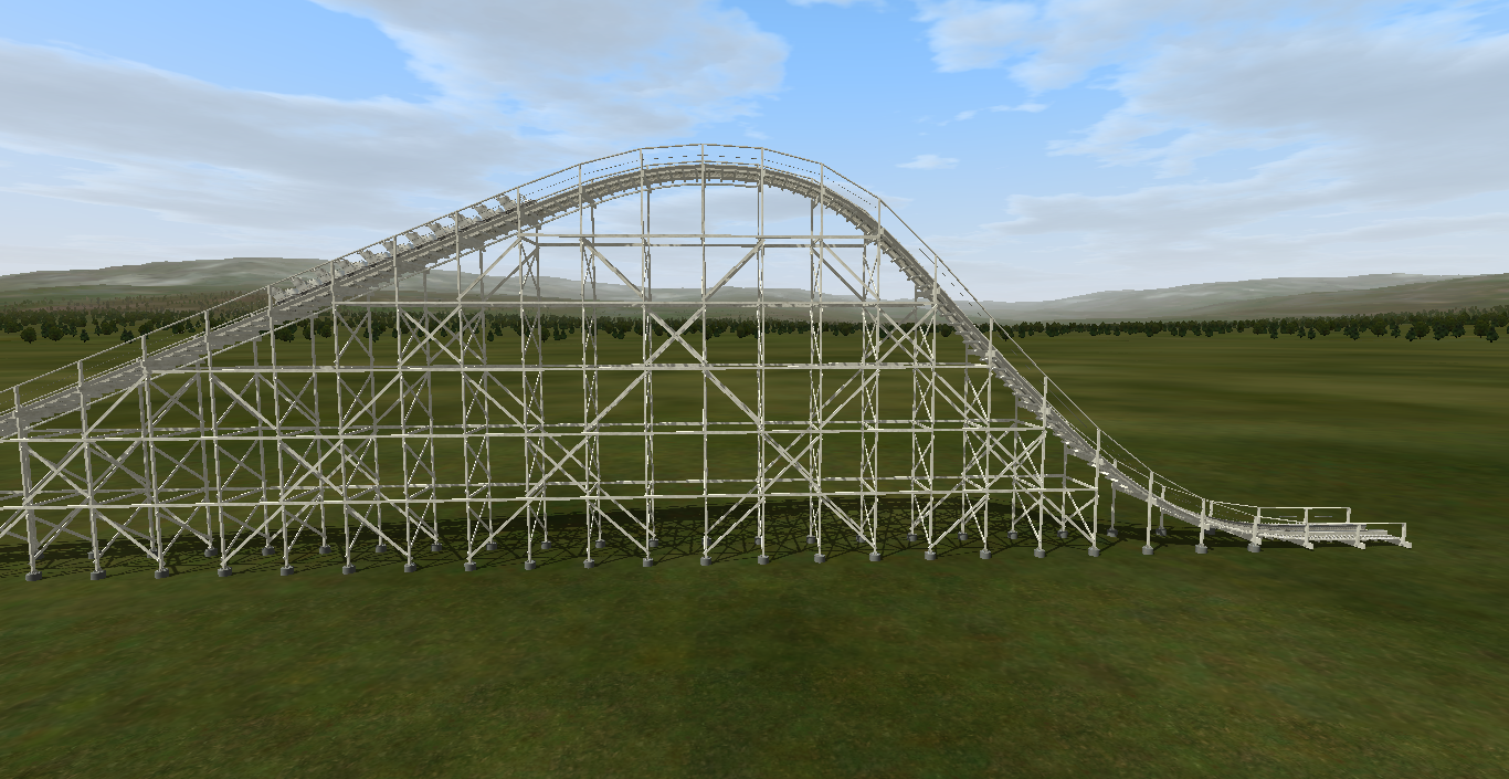

Fair point, I'll give it a go. It may be easier for me to make all the sections horizontal in Newton 2 and then use that to guide the placing of my supports.
Post January 11th, 2016, 7:14 am
Posts: 111
Okay, I used a combination of your ideas. I made a 3.048 metre (10 foot) piece of straight, level track and saved it as an element. This is the spacing of the bents on the straight sections. Then I strung 30 of them together and raised the heights every 3.048 metres to match those marked on the blueprints. Don't worry, I used the same units for bent spacing as for height! Deleting the superfluous nodes then gave me the perfectly shaped lift hill and drop. Wood magic was used for the supports.
Ahhh, That's better! :lol:
Points to note:
1) Positive vertical Gs were safe - with default friction it reached exactly 3g at the bottom of the drop in the back car, and 2.5g at the front. The back car got 0.8g as it was whipped over the crest of the lift.
2) Top speed was 40 mph. I threw in a straight section before curving around to return to the station and it hit 42 mph, so there's potential there. :)
