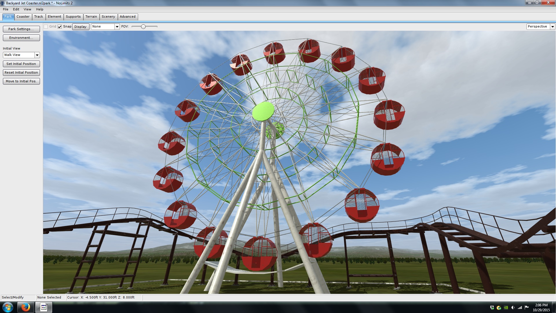

I've just made a small flat ride for everyone to use:
Small Ferris Wheel
This is a pretty basic small ferris wheel for everyone to use. It's lightly based on the Zamperla ferris wheels.
To place it in your park, just unzip the file in your park directory and place it in your park like you do with all other scenery.
Anyone may use it without credit.
Download link: NL2FLAT-Small-Ferris-Wheel

Does the Ferris wheel move and it it rideable?
herman116 User avatar
Posts: 636
^ It does move and it's rideable. ;)
