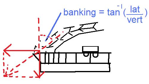

^The methods you guys are providing are really useless. Banking can be determinded beforehand, but you will need to input two of three parameters. Speed, radius and force will determine how much banking you need. However, this only applies to flat turns.
A simpeler method is to build the turn first, and then see what the vertical and lateral forces are. Then you use the formula:
banking = arctan ( Lateral / Vertical ) and there's your banking.
The nice thing about this formula is that it can also be applied to every turn, not just flat ones.
Here's a diagram to illustrate the function:
20.56 KB
