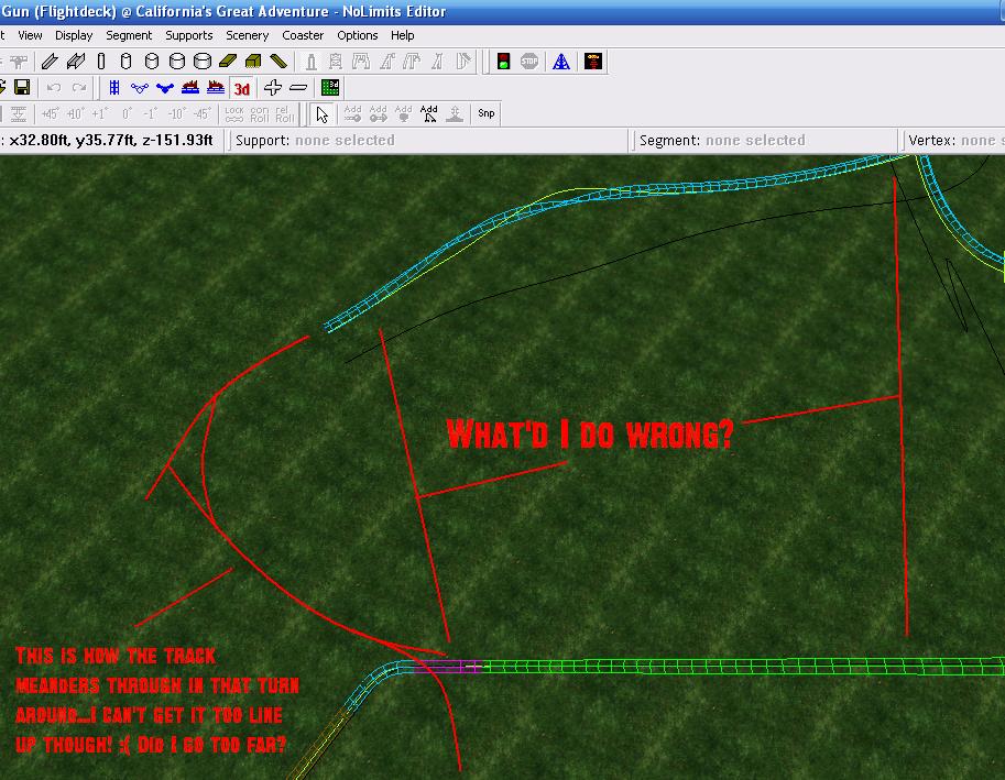

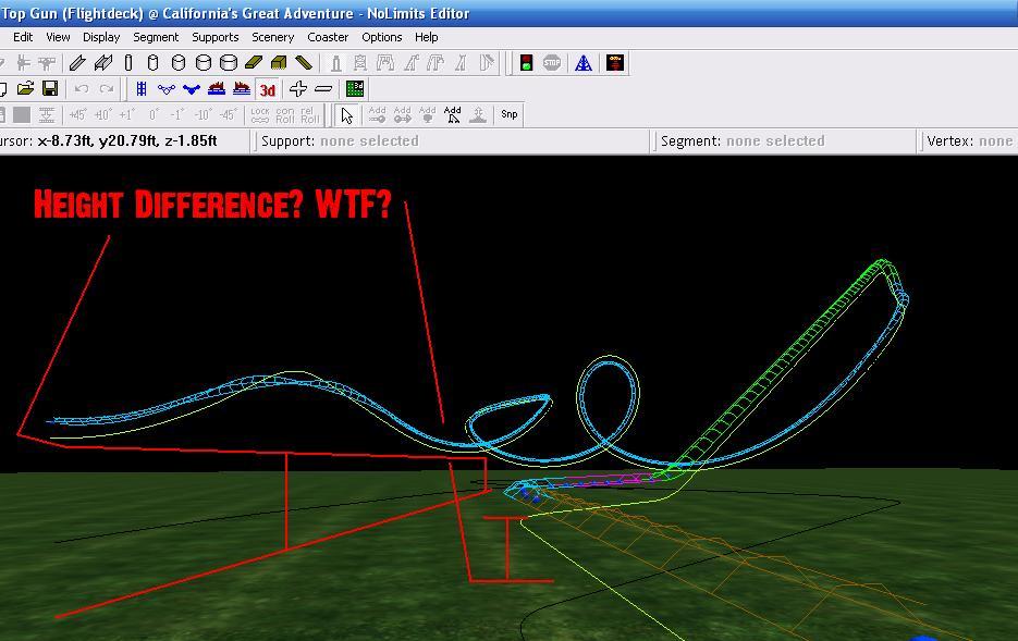

So far, i've gotten the drop, loop, turn around-helix thingie, and camelback down pretty well. Just trying to work on getting the trajectory of the second "turn around over the station and brakes before the lift s-bend thing". I'm having trouble as well...no matter how much I scale down certain parts of the ride or reshape them, I can never get the height, or the trajectory of the turn around to hit just right...
Is there a terrain difference i'm missing? The ride looks like it's set on pretty flat ground but I might be mistaken.

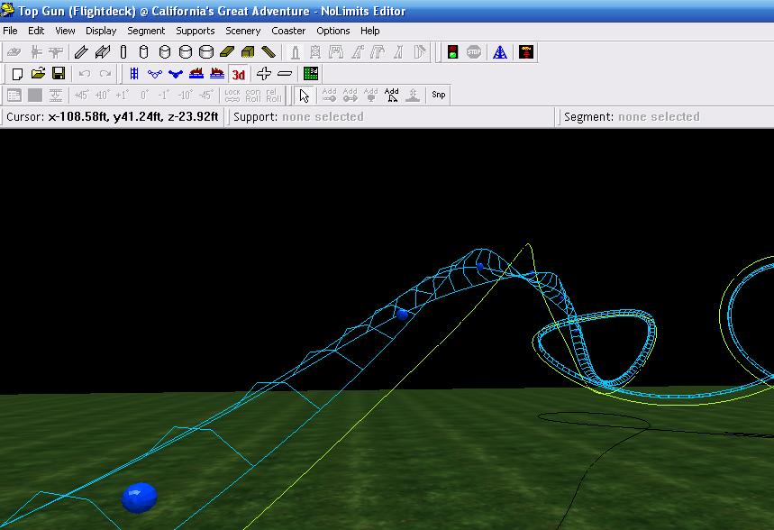

Overview of what I have so far:
78.82 KB
Pretty pre-drop and drop:
89.06 KB

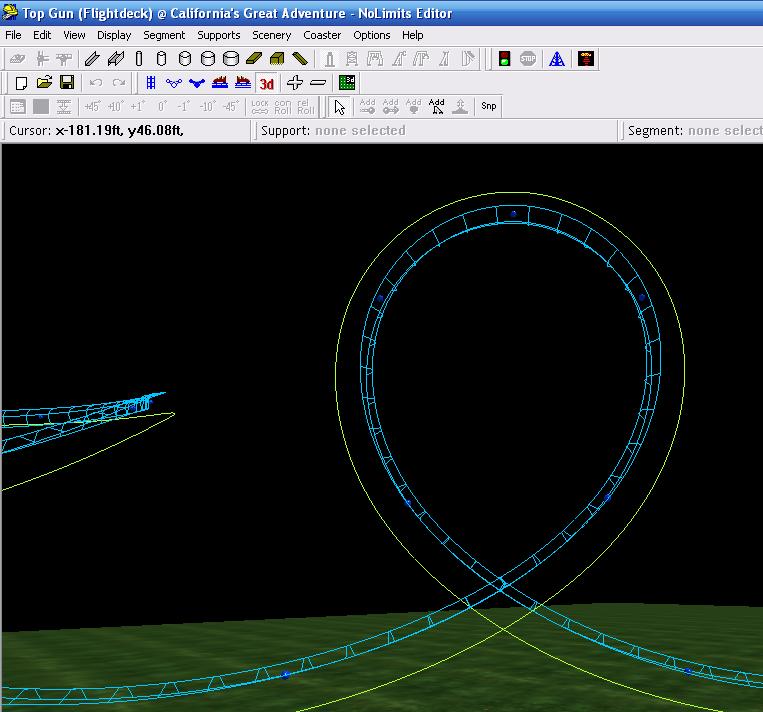

Oh my GOD was this loop a pain (took me HOURS to get right):
72.61 KB
Am I missing something? Does this ride have a terrain difference?:
72.91 KB

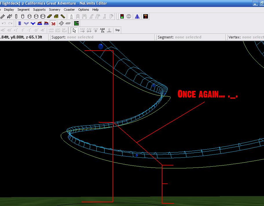

Yes, that rides as pretty as it looks:
69.46 KB

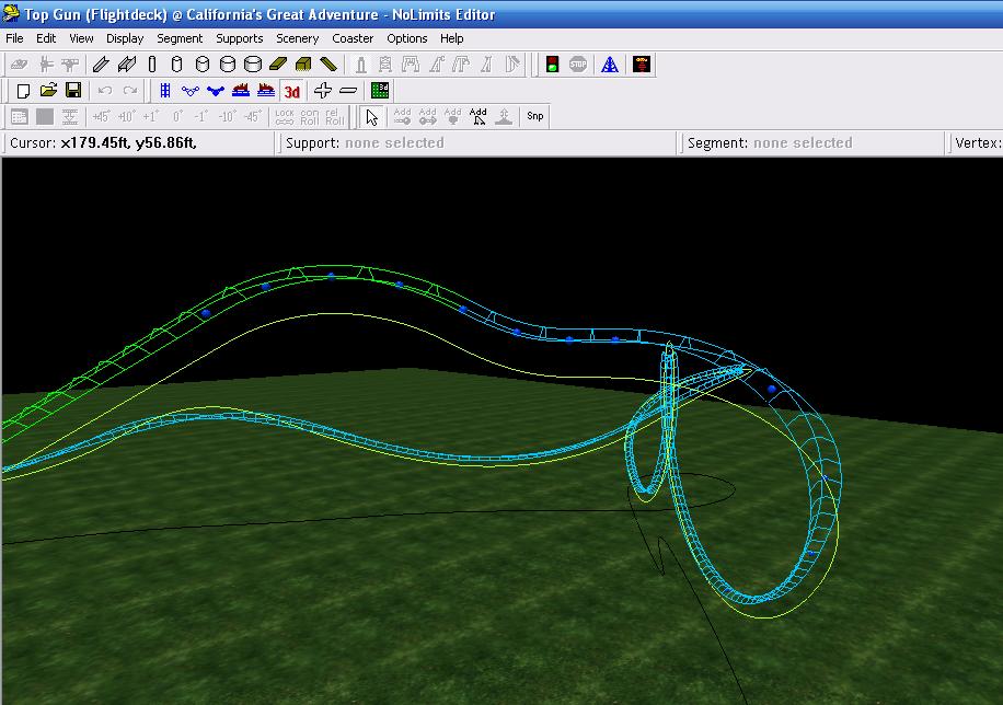

Helpp me![:(]:
118.75 KB
edit - spelling mistake in above pic. [B)]

I think that your shaping needs some serious work. The drop needs to be steeper with more banking on the turn (watch some POV's, you'll see what I mean), the turnaround needs to be a bit taller with more banking on the apex of it and the 0g roll needs some work. When looking at an 0g roll, you want the heartline to be a perfectly straight parabola all the way through the element, but this can differ given more positive or negative G's. You also need to take the apex center of the roll and pull it down a bit from what I'm seeing. I realize that this is difficult to achieve when handbuilding, but I thought I might just let you know just in case you didn't. Lastly, the loop needs to be a bit tighter at the top with a bit of a tighter lead in and out. This will help the layout of the ride be more accurate to the real one. These are just my 2 cents, and I hope it helps. :)

Thank you for your help, and i'm not trying to judge you flickstah (I know you're trying to help)...but, lol, I did watch POV's, and I did do my homework, and I still can't get it right [:(]. I looked at many pics, and the loop shaping is older (it was an older B&M) not so tight at the top, pulls more G's throughout (mine hits 4 G's): http://rcdb.com/80.htm?p=1319
Turn around: http://rcdb.com/80.htm?p=1317
