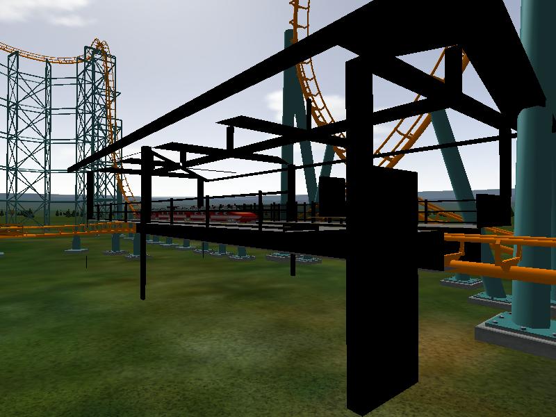

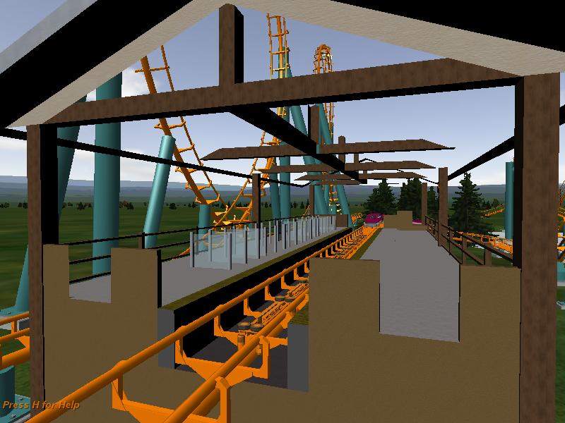

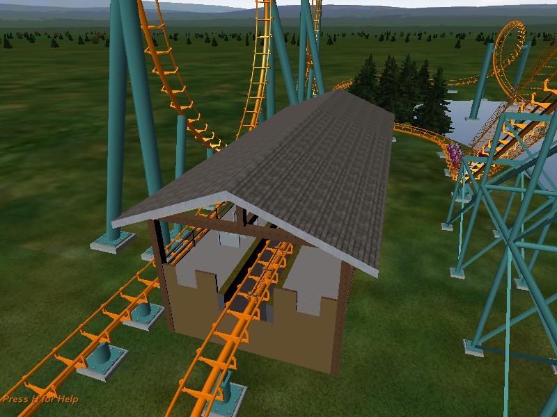

I was creating my station in sketch-up and I decided to export it to make sure it was all right, this is what I got...
73.73 KB
80.55 KB
77.02 KB
Why is it doing this? Does anyone know. I tried searching the forums but I got no answers..
can someone help me?

the face is backwards, reverse the face which is invisible (right click--> reverse faces) and then that should work

You have shaded sides of the faces outwards (look at your scene in...monochrome i think, and you'll see white and shaded faces). If you export what you have, the shaded faces are invisible. You can either export double sided (which you shouldn't generally do unless you have flat planes with textures on both sides, like say on fencing) or flip the faces and retexture the parts that showed up clear.
Your lighting is off too...there are ways to fix that listed here and there, but I'm not sure the exact technique as I haven't done it myself. General idea is to run it through a different program and fix the ambient lighting, or something to that effect.

The face isn't backwards, the issue isn't quite that simple. Simply reversing it will make it visible from the other side, but invisible from the original side.
The issue is that Sketchup displays it's polygons as two sided, visible from both the front and back, while most other 3d programs including NoLimits only displays the front. Polygons are invisible from the back due to a common optimization technique called back-face culling which assumes polygons facing away from the camera will be obscured by polygons closer to the camera, so they can be ignored.
Fortunately you can use the 'Export two-sided' option to fix this without much effort. Read more about Sketchups 2 sided faces and some other things you might need to know about Sketchup here: http://sketchup.google.com/support/bin/ ... wer=114323
This is a particular pain in simpler programs like Anim8tor where in order to make a simple 2 sided plane you have to make a flat square with 2 triangles than duplicate them and flip the duplicates 180 degrees. Because of this the trees in Silver Mountain which look like 2 simple planes are in fact 4 planes, or 8 triangles. Which makes for more complex texture mapping, particularly if you want them to be symmetrical front-to-back.

Well you've made me interested in the ride lol. The drop in the last pic looks incredible.

Thanks again for the help, It did work.
