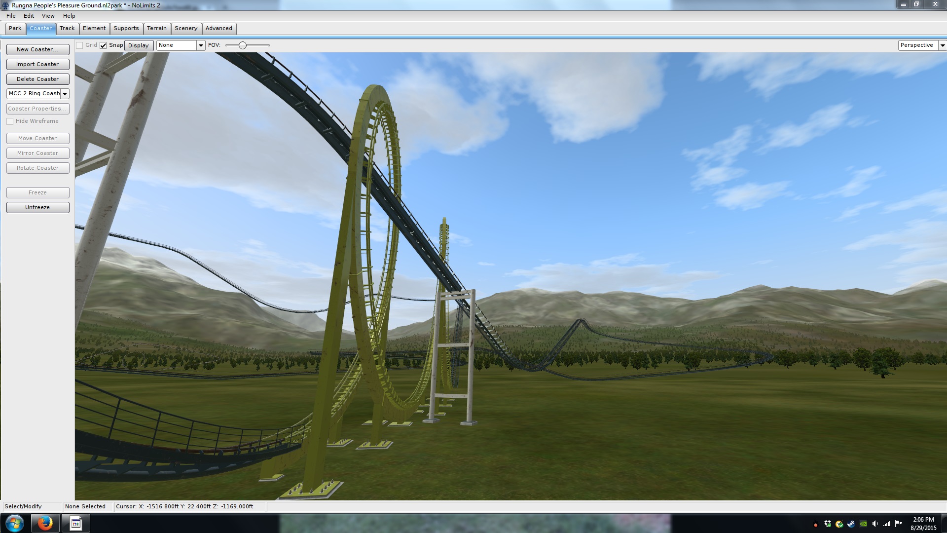

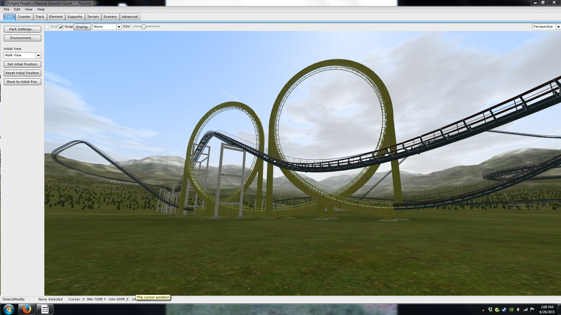

I find that, for the most part, using the G-Force comb is a huge asset when supporting but as soon as that comb rises beyond 60-70 degrees we have to start thinking about saving steel and lateral forces on the support itself (more steel=more weight). Also we can't have a lateral brace shooting out a couple hundred feet as it's not practical or beneficial. I don't think I'm overthinking it but I do think I'm not explaining it well. Screenshots to come later. Everything that has been said so far is on-point! Love that I'm not actually crazy because I obsess over supporting my coasters properly (until we have a stress comb, of course). A stress comb would be HUGELY beneficial in supporting our coasters, but it would remove the dark-magic-effect of good supporting!
Here is an example from my most recent coaster, Dragonfly, that has a slight over-banked turn. As you can see the G-force comb is just over 90 degrees. My decision to use exterior lateral supports seemed appropriate. In this situation perhaps they can go either way. Thoughts?
