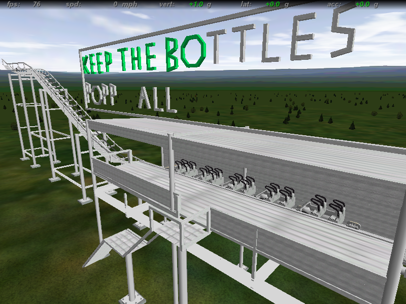

Post December 27th, 2010, 6:34 pm
Like my jet coaster station that I am working on that has catwalks.
