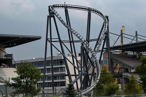

The more I look at ring racer the more things seem just plain wrong. First off looking at the videos of the launches on youtube it doesn't appear that the trains are travelling anywhere NEAR 135MPH. It looks as though they may not even be topping 100Mph.
There was another thing that I noticed that looked impossible. The turn at the top is extremely tight yet it is only 132ft off the ground, so it is taken with extreme speed. Using some calculations I determined that a train launched at 135MPH would traverse the top of that curve at approximately 119MPH!
I don't see how anyone could survive a turn that sharp at that kind of speed, not to mention the transitions between banking.
Are my calculations correct, and if so what kind of G-forces are we looking at?

Umm, in case you didn't know, there are brakes right after the launch, so it slows to about 90ish (correct me if im wrong) before it gets into that curve. It also has yet to run at top speed due to technical issues, so any videos you have seen have not been at 135mph.

the train does launch to 135, then immediately hits brakes in order to take that turn. Its meant to simulate a real racing scenario, such as a car, accelerating down a straight, then having to slam the brakes to make a hairpin turn. The whole track was designed to simulate a real racing experience.

Ok good! It seems rather a rip off to use the power to get a coaster train up to 135 mph only to slow it down to 90 immediatly afterwards. Is there a point?
^that is dissapointing! I see the concept but still very dissapointing. What kinds of problems are they experiencing.

I thought it decelerated to about 60-70ish?

60 is too slow to carry it through. 70 would bring it to about 30 at the top, and 90 would make it reach 64.4mph.... which still seems a little fast.

The minimum velocity to make it through the curve with the proper coefficient of friction is 69mph.

It wasn't meant to distract from the racing experience.
