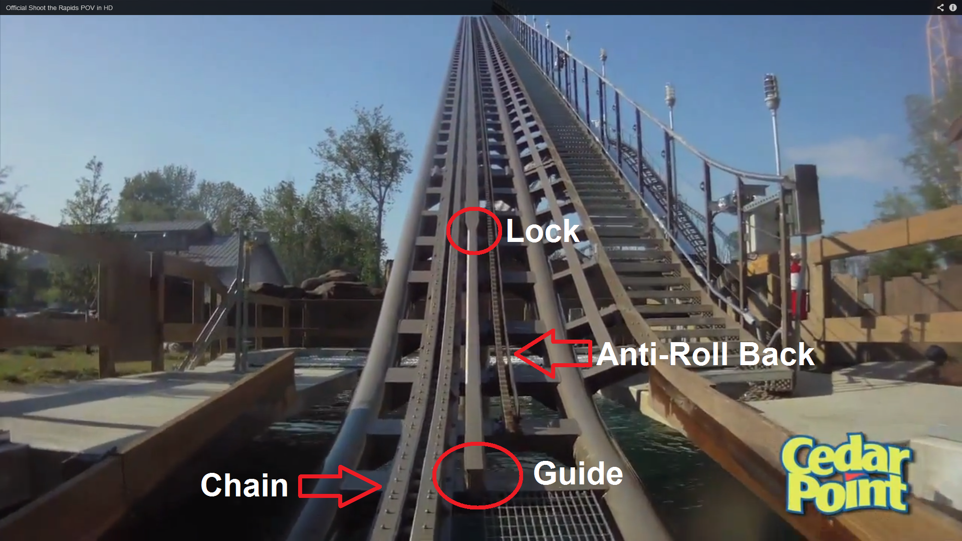

Post July 20th, 2013, 11:28 pm
Posts: 1018
Location: Akron, Oh, USA
Originally posted by Cali Coaster
What you can't see in the picture is that the boat does "connect" with the track in a center piece. "Locking" the boat to the track.
I tried to point it out below...
3100.52 KB
