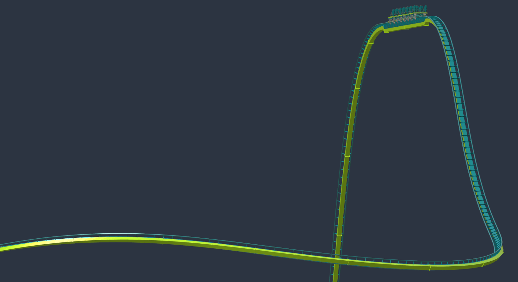

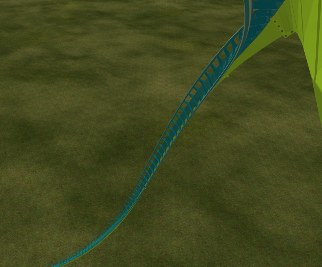

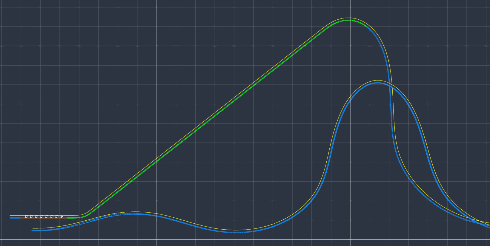

Mainly for the drop. I've compared my drop to the drop of Leviathan, and it's clear that my drop is nothing like Leviathan's, which is much much more gradual than mine, and seemingly not as steep. However, I really love the way my drop rides and how the g's are in each seat. So, what do you guys think of it:

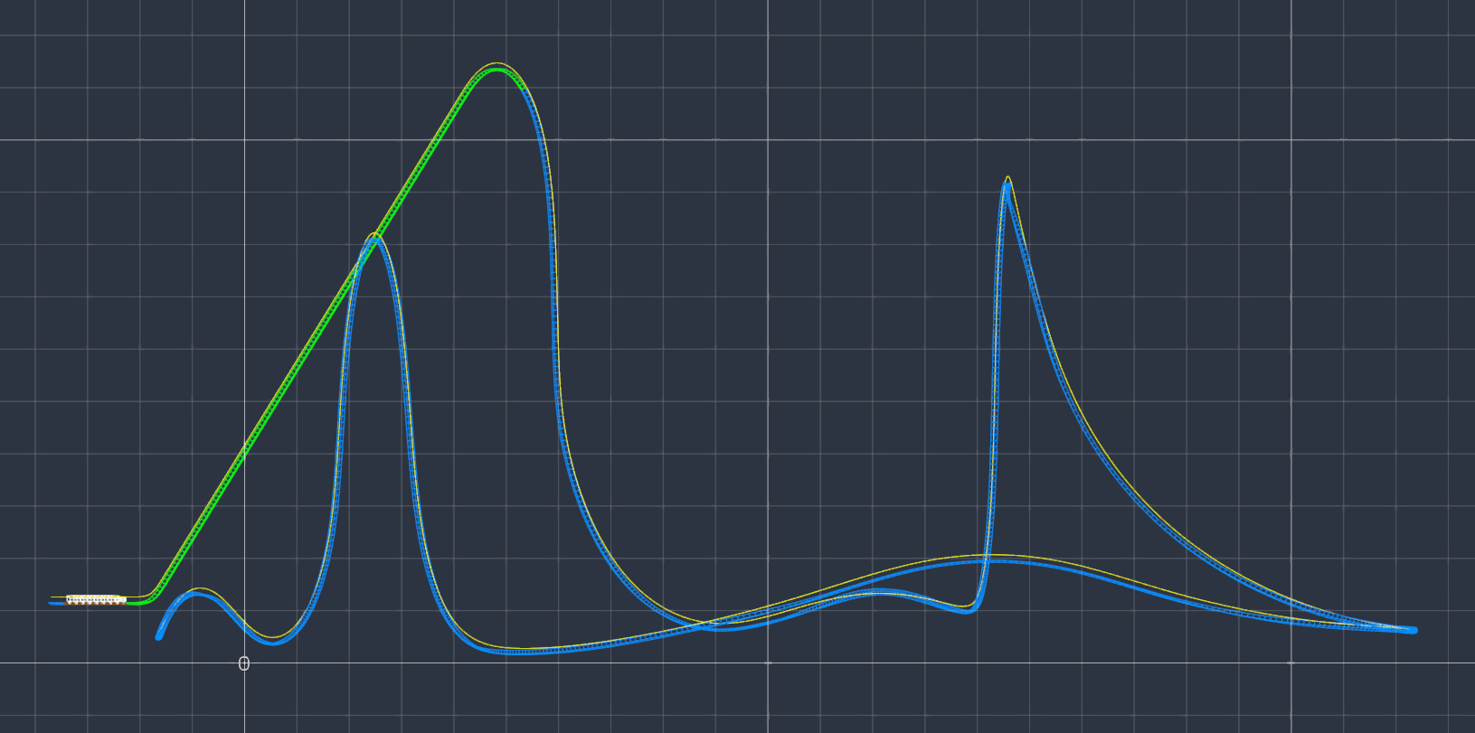

This is the layout so far. As usual, the rest of the layout is already planned out on paper, it's just not on NL2 yet. I've tried to get a bit of mix between the low-to-the-ground high speed stuff, and big airtime hills.

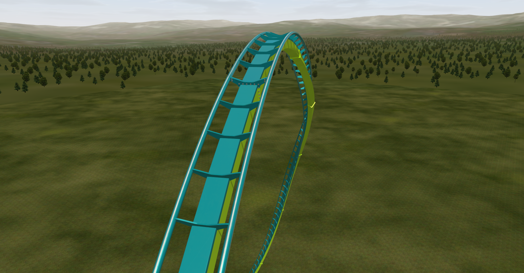

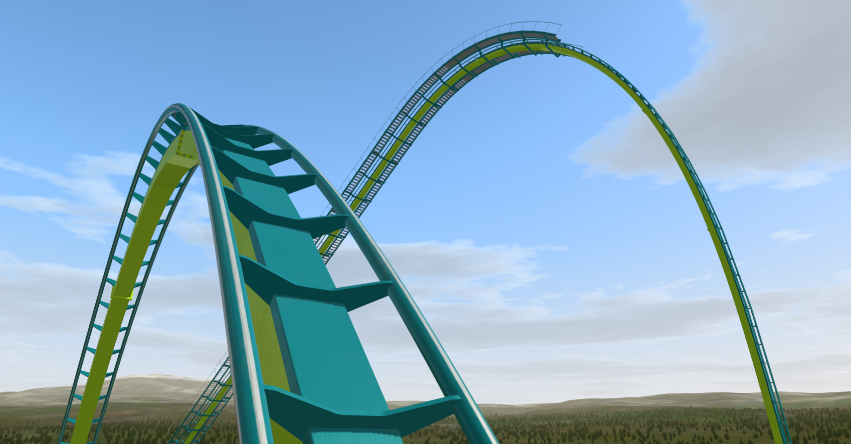

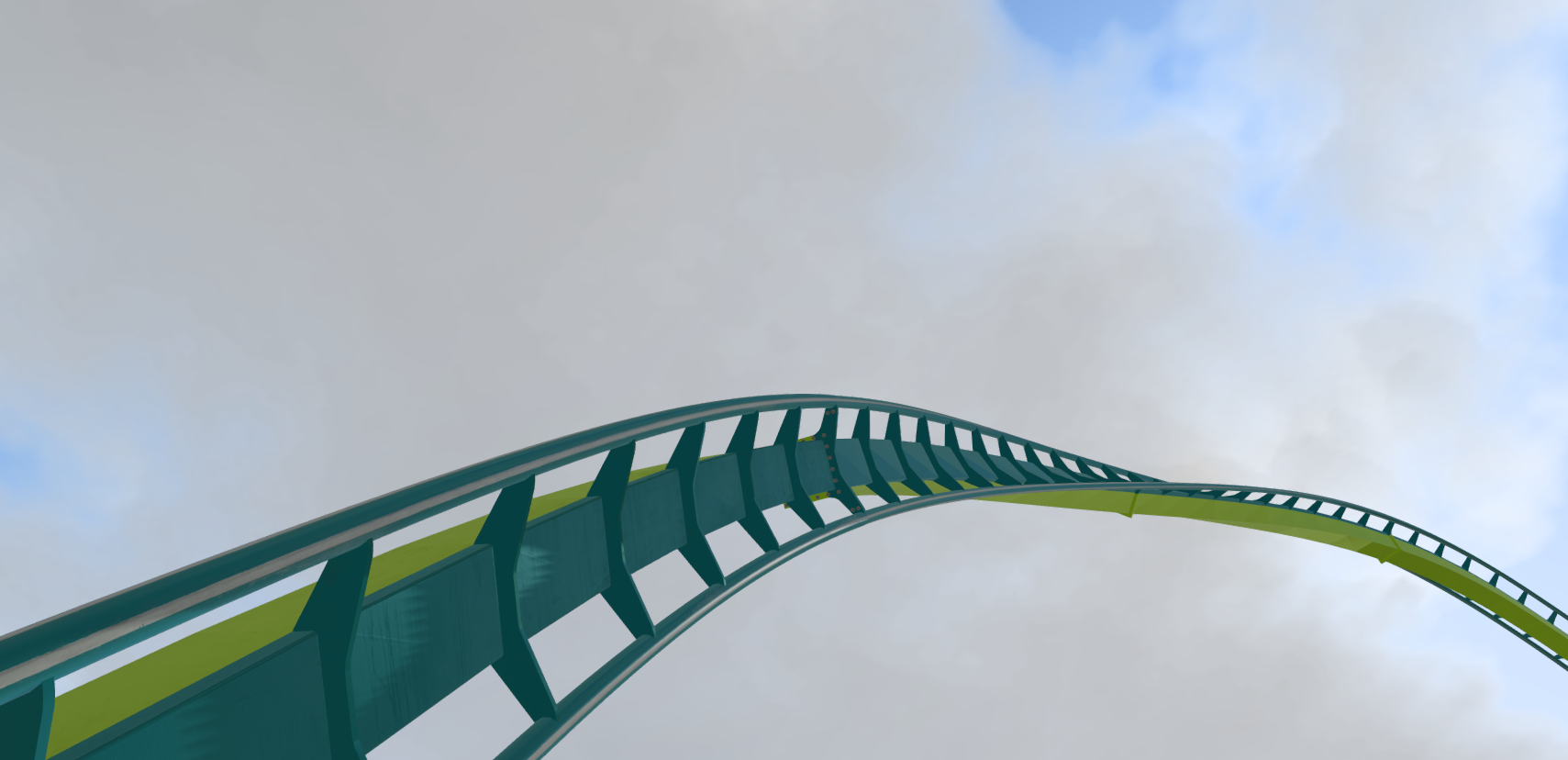

The top of the 270ft Airhill (gives you an idea of the height of the drop ;)), with the top of the drop in the background.

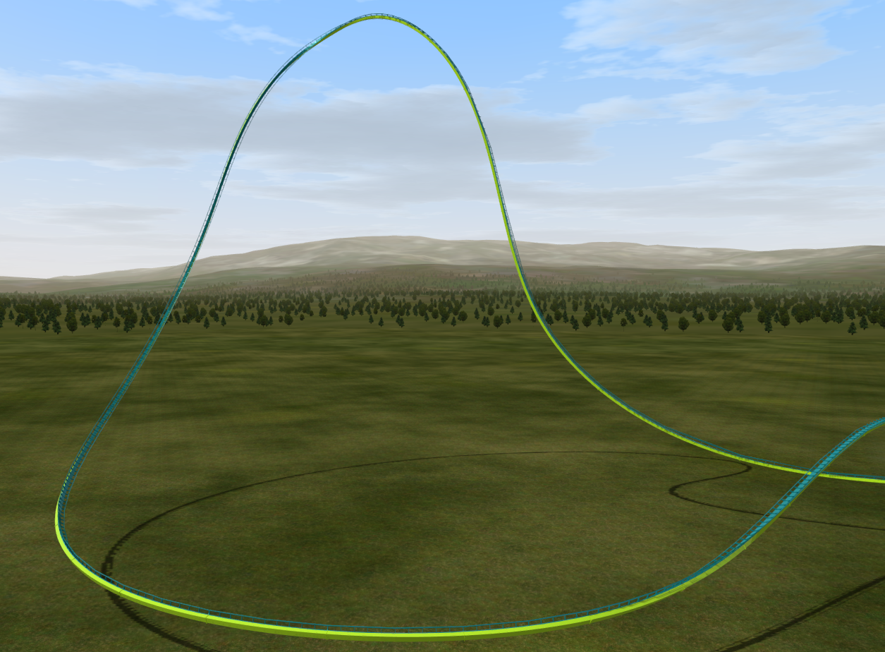

Some images of the first turnaround element, because I'm very proud of the way it turned out - it rides so nicely!

Comments and advice greatly appreciated, especially concerning the drop shaping!

I love the colors but I'm sure you could find something more original to differ from Fury! I like the drop and I know many would complain that is not extremely accurate for a B&M but if your forces are good and you like how it rides I'm on your side and I wouldn't change it. The turnaround tho seems a bit too vertical (or beyond) but could easily be the picture.. Can you post a better one maybe more far away with different angles?
I also like the layout, looks fun to ride!

It's kind of difficult to take a picture of the whole thing where there's still enough detail for you to see what's going on, because it's bloody huge!
It is steep, but it's definitely not vertical or over vertical - it's certainly not as steep as the first drop is, which is about 85 degrees at the steepest point.
With regards to the drop. I may move the station backwards and make the drop slightly shallower than it is at the moment. As awesome as it is to ride, I really don't think it's particularly B&My. I'll keep it for now, I think. I see how my mind changes over time.

I can't tell what it is but looks a bit weird.. Maybe the rotation start a bit too late, maybe the top is too narrow, maybe it reminds me of the intamin blitz curve close to the ground.... But I'm curious to see more!

That is a steep air hill lol.
It is very steep, but even in the first image (perpendicular to the drop), the view on the air hill isn't actually side on, so it does look slightly steeper than it actually is.
Post October 4th, 2014, 5:21 pm
You can reference the heartline distance and easily tell how offset that screenshot is, and I have to say honestly, all originality or creativity aside, that airtime hill looks absolutely abysmal.
:lol: there is much work yet to be done!
Gigas are definitely not my bread and butter, this is genuinely the first one I've even attempted and I've certainly never seen one with my own eyes, so there are bound to be a fair few oddities in these first few screenshots while I'm getting the layout down. That's why the thread is here, so hopefully with your advice and such, I might end up with something partway realistic :lol:
How I arrived at the shape of that air hill was by putting in a basic hill shape (which was originally shallower and not as tall), and then tweaked and rode and tweaked and rode until I arrived at a point where the track was smooth and the g's were almost constant from inflection point to inflection point. It rides very nicely, but obviously based on the reaction, it looks like poop haha.
Pointers, please!

The airtime hill just has way too steep of an entrance and exit, if you just make it a bit more stretched out, it should look fine.

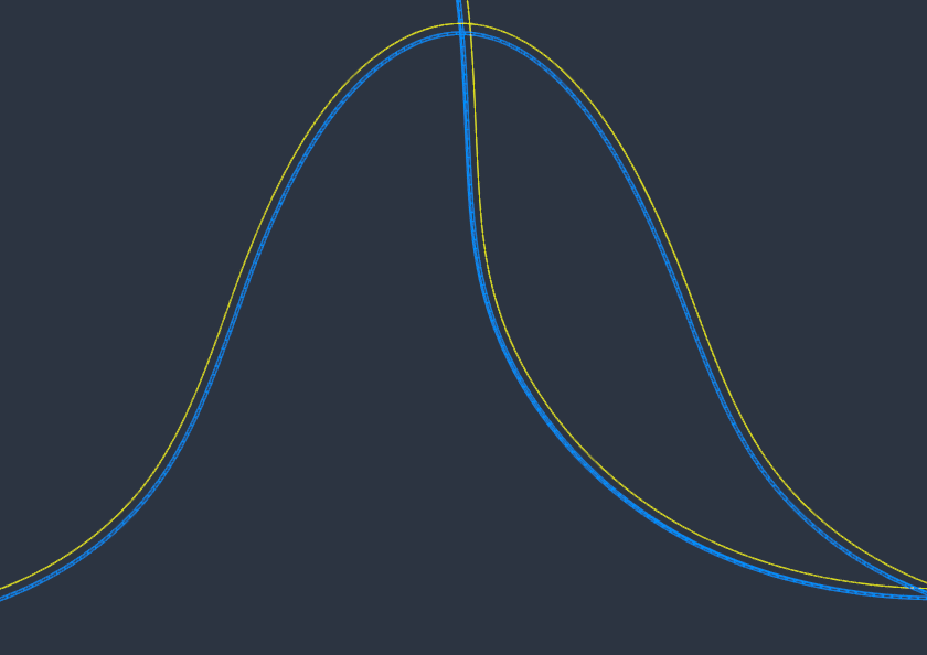

How about this:
It's now 264ft tall, rather than 270ft, and it's a fair bit wider at the base!
It still looks like it's very steep, but I'm finding a little hard to say whether it's ok or not compared to other B&M hills, because this is 260+ft tall - there's not a hill (I can think of) to directly compare it to.
Pretty sure I'm going to make the drop less steep also, to bring it more in line with Leviathan's drop. It is awesome and everything, but... look at it in that picture :lol:

It looks a lot better! As you said it does still look a little steep but I think it will be fine considering how tall the hill is. Make sure your G forces are fine.
Post October 6th, 2014, 3:16 am
The hill is built entirely based on the g-force (which I believe is how B&M does it), so it's the g force that has given the hill its shape.
That particular hill has a fairly stable 3.5g pull up at either side, and then the whole hill stays at a fairly constant 0g (in the middle seat) between the two inflection points. I'm really happy with the way it turned out in terms of how it rides. I'm finding NL2 much much better at NL1 for producing decent force based rides using only handbuilding, and still having a really smooth track.
