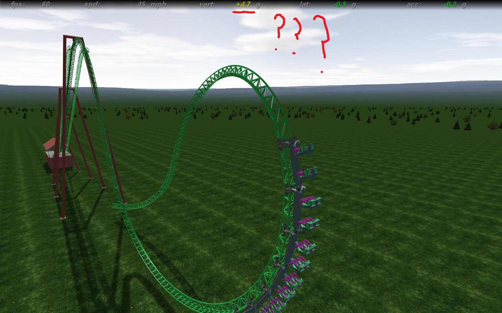

I'm having issues with newton. Not like, running issues, it runs fine. but, i can't seem to get the Gforces right during an immelman. The immelman is perfectly shaped,(i actually followed the tutorial to make it) and i have it set to the typical geforces seen on an immelman,(about 3.4 or so) however, when riding in the simulator, the immelman clips about 4.8 g's!!!, i made sure the speed settings on my drop were correct, so why would the g's in the sim be different from newton??? Entropy, if you could PM me i could show you what i mean.

have you set the correct hearline in newton for the type of track you are building?
Post September 25th, 2009, 11:59 am
Posts: 1384
^ ya, -0.9...

Where exactly is the 3.4G point in your immelman?
It should be at the very bottom. Immelmans are basically transitions from 3.4 (in your case) at the bottom, to close to 0 at the top. Sometimes 0.8 ish works well too, but you have to have enough speed.
Also, where did you measure the speed of the train? It should be the middle row. Newton basically sees the train as a single point, which is the centre of the train. The further you sit from that point, the more the forces differ from what you put in.
That's a good question. I don't recall there being any large g-spike in the tutorial element (though I can't confirm that at the moment), but then again I was using a different track type. Intamin inverted trains are usually much longer than B&M, and have a slightly different heartline values, and these can all come into play. I would consider the tutorial to be more of a guideline than to be slavishly followed. You may have to adapt it to fit the train type, approach, speed, etc. Also, and maybe it's my eyes playing tricks on me from the perspective, but that Immelmann looks kinda strange to me!?!?
Post September 25th, 2009, 3:00 pm
NO WORRIES I KNOW THE REASON! It has nothing to do with the shaping. It is simply that you are sitting in the front of a long train, and the middle is the center of gravity, so you are going just as fast as the middle, but at the far tighter radiused part of the immelman. When newton calculates forces, it calculates for the middle car because its the center of gravity. Ride it in the middle of the train and tell me if it has the spike.
I had the very same problem on my coaster inertia. It gets a yellow spike on its immelman in the front also, but not in the middle.
Post September 25th, 2009, 3:23 pm
Posts: 1384
^ i completly reshaped the element, and reduced the g's majorly. Its still doing it. now its clipping about 5.3 in the front, however, the middle train is fine...
This is not quite right. newton assumes the train is a point particle travelling along the path. Since it's just a point, the center of mass is just the point itself. However, in a train, the center of mass isn't necessarily the middle car--it can be above or below it if the train traverses a valley or hill, respectively. This means the train may be travelling a little slower through a valley and little faster over a hill then newton expects. Anyway, your basic point was correct.
Post September 25th, 2009, 4:06 pm
Posts: 1674
Points on hand: 201.00 Points
Location: Zelezniki, Slovenia
I just said that 5 posts above...
