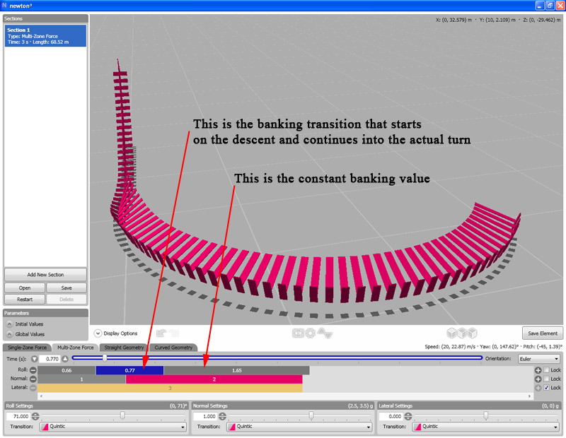

What's the easiest way to make flat banked turns like on Intamin Megalites and Intimidator 305...I've been trying everything to get it to work but none of mine look right. Anyone have any suggestions?

Posts: 5268
banking will be around 70-75 degrees when laid flat. I can tell you that much. Hard to say since we dont know anything else like entrance speeds, angles, g's, etc.

Even with setting the banking to 70-75 degrees the turns still tend to rise or fall like a helix...Is there generally a good value for the geforce in a turn like this...I've tried high g's, low positives over 1 and I can't seem to hit it on the mark. I'm generally using these turns at the bottom of drops so they're generally going to start with 2.5 to 3.2 g's.
Youll need to create an entrance to the helix at around 70 degrees. then, create another force section, keeping it at 0 degrees. Then, go back and play with the previous banking if that isnt perfectly level. The G's in the turn dont matter. If it banks up or down its because the banking is causing it too.
So add or subtract banking from it.
