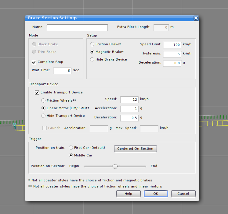

Anyone any idea why the "launch" checkbox is greyed out on this brake segment?
Tried changing all the other settings, but no combination of settings allows you to check the "launch" checkbox. Quite important for the brake segment at the start of a launch. At the moment, the train just rolls back off the brake when it's released from the complete stop.
