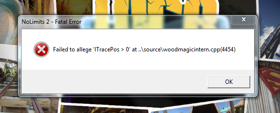

I just crashed NL2 for the first time... Basically, this happened: I started a new track (was going to make a woodie)...I got everything set up, and thought I'd jump the gun and go to the auto support generator for preview purposes before I laid down my first vertex. So yea, this happened :)
117.32 KB
